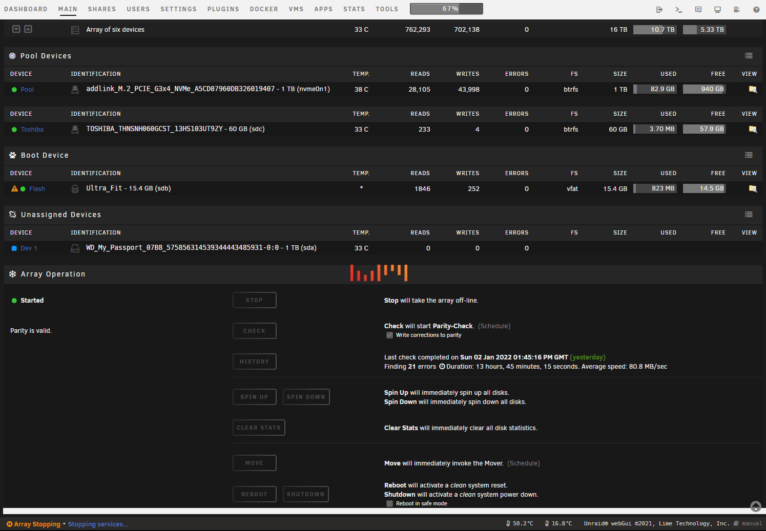

  20. Hi, I had a pair of disks with UDMA CRC errors so I decided to swap out for some WD Golds, which has not been an issue before. This time after leaving the UnRaid unattended it will crash, I think (No syslog to tell me what happened apart from the below) Nothing to tell me in fix common problems. Could it be permission related as I had to use mover to get the data off the disks. Thanks, Luca
