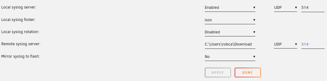

What's a good size to set the maximum file size to?

syslog-127.0.0.1.log I did have it mirrored to flash. I just pulled the diagnostics and attached.
