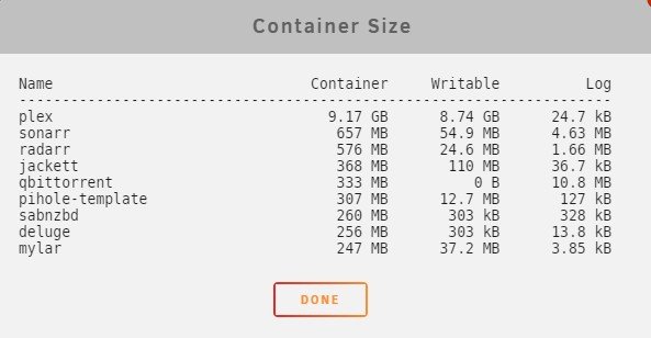

  4. Just to note for those having the expanding container size problem, turning off the intro markers as discusses a few posts ago fixed the problem for me. I didn't change the TMP folder location on my setup either.
  5. In unraid go to the Docker page. At the bottom of the list of containers is "Container Size" button.
  6. Here you go. I included the docker container sizes to show that since I last posted yesterday the container has grown to <9GB.
  7. Yeah I meant the docker. I get warnings for the total Docker img size but the plex container is taking up most of the space. The rest of my containers are all around 500MB or less and I only have <10. Just to note, in the past 5 hours the plex container has grown by around 200 MB. I’ve watched stuff on plex for about an hour in that time.
  8. I'm having issues with my Plex docker in the last week. The docker img size is growing pretty rapidly and it maxes out my assigned size (20GB) after 3-5 days. Twice this week I've had to stop docker, change some settings, and restart it. This seems to clear whatever data is building up in Plex. I did this yesterday and when it restarted the plex docker img was <700 MB. It is now >9GB. When this first happened last week the plex docker was 19GB. I've looked at a couple things and all of my folder paths haven't changed. The only thing I can think is that the transcode process is doing something funny. My transcode folder is set to /tmp. I'm running Unraid 6.8.3 and the Plex docker is up to date. I actually just forced an update on it to be sure and the docker size is back down to <600 MB.
