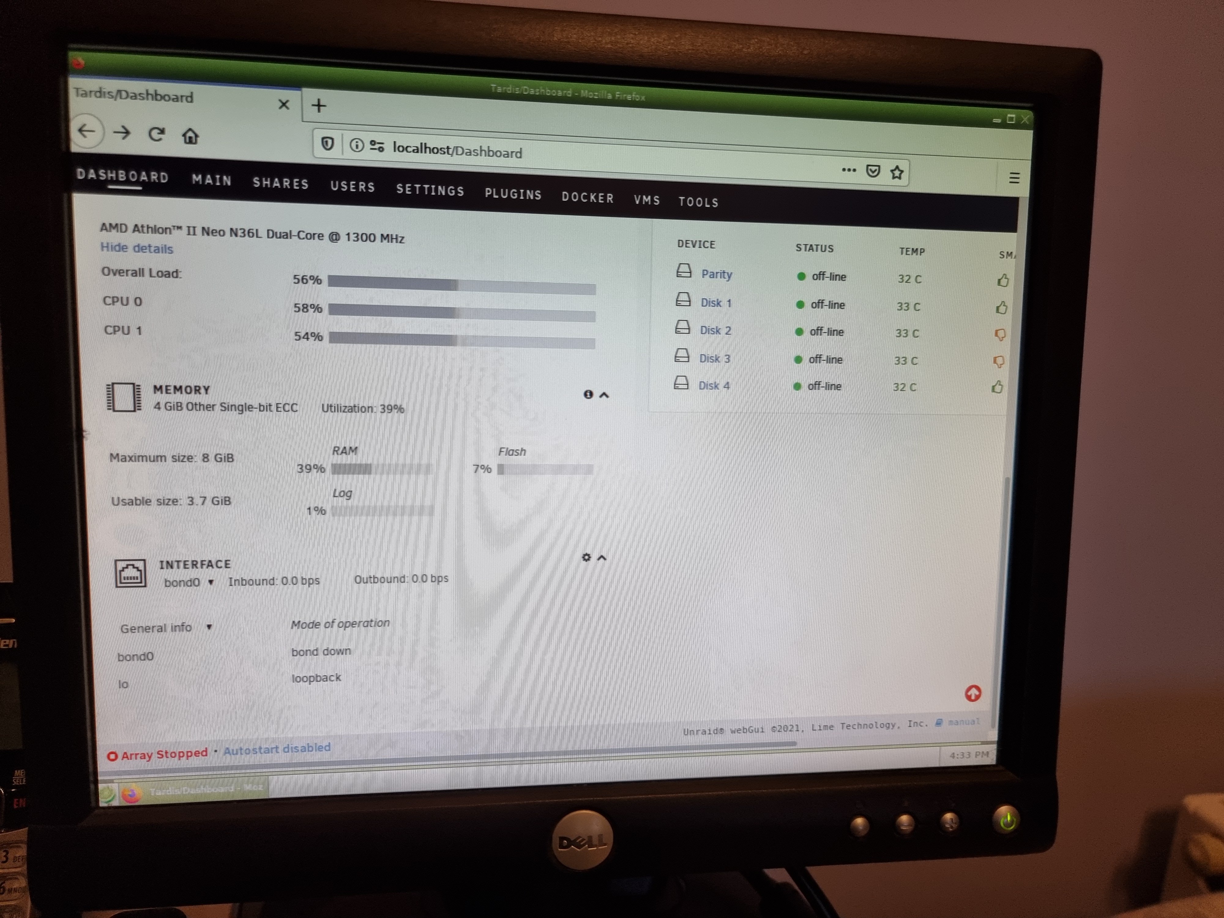

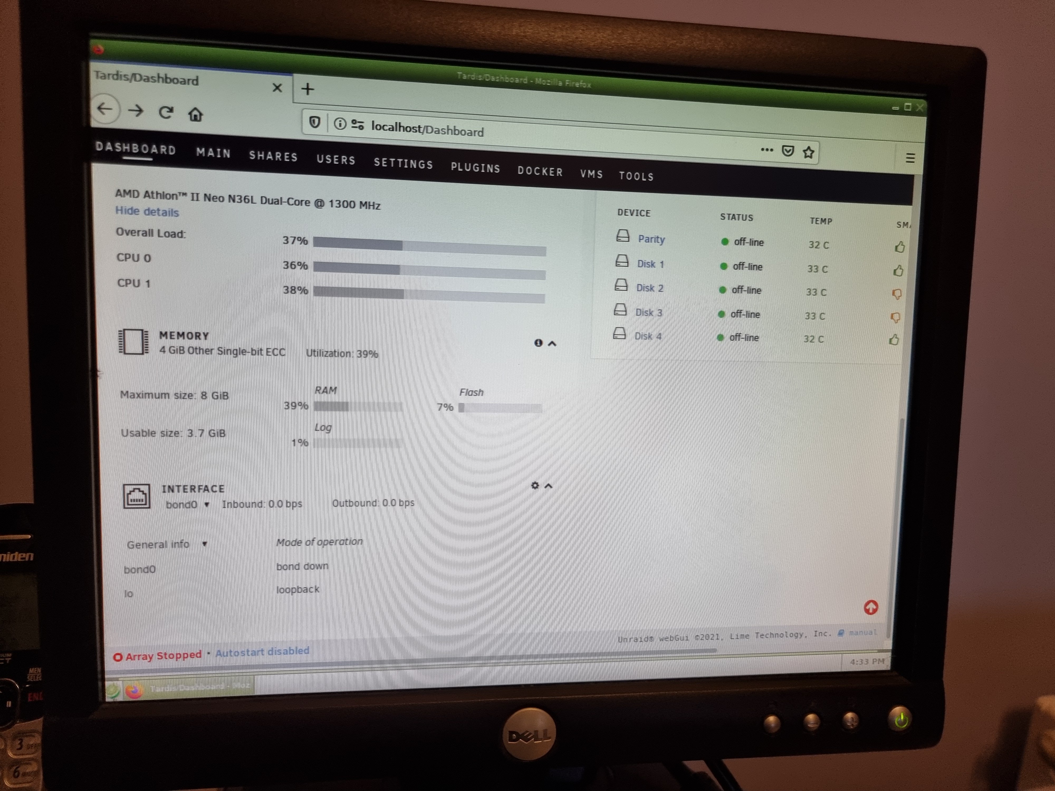

  5. Changing network settings back to static IPs, etc made no difference status still shows as bond0, bond down and lo, loopback. Looks like it's definitely a dead nic.

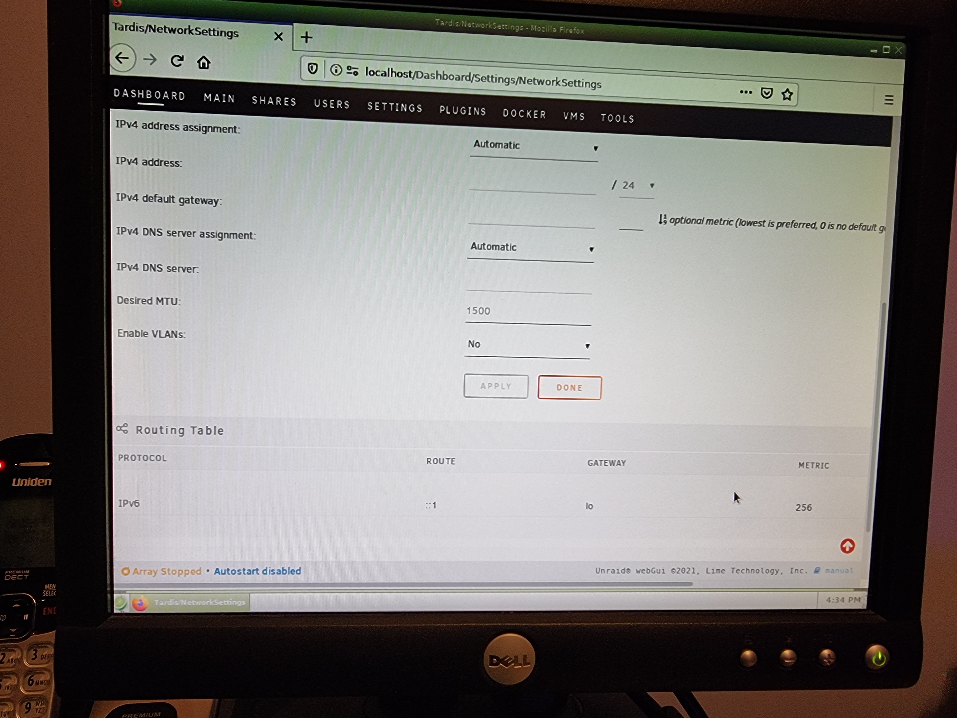

  6. As a test I renamed the network.cfg file then rebooted and this is what I get for network settings now (see screen shots).

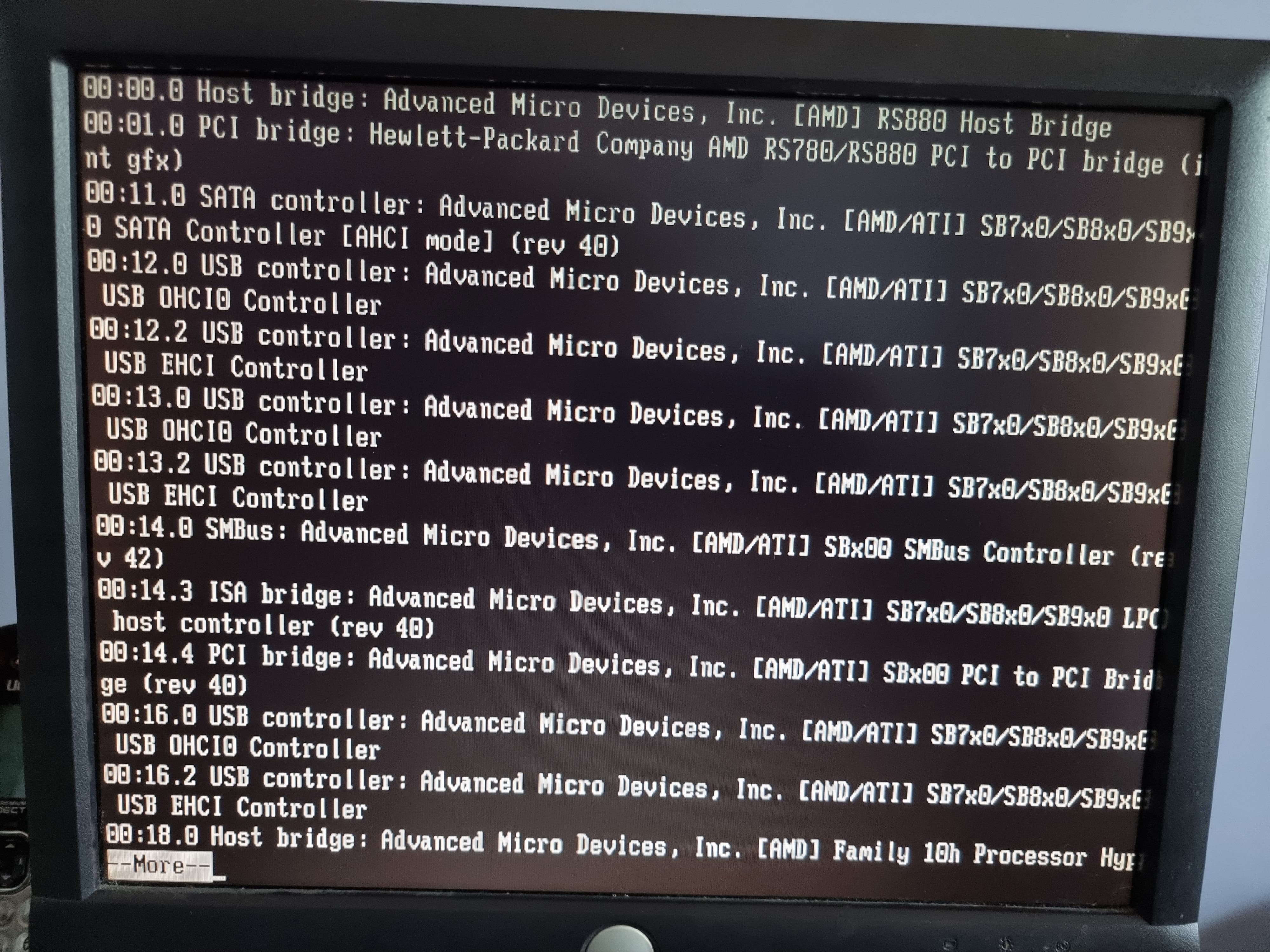

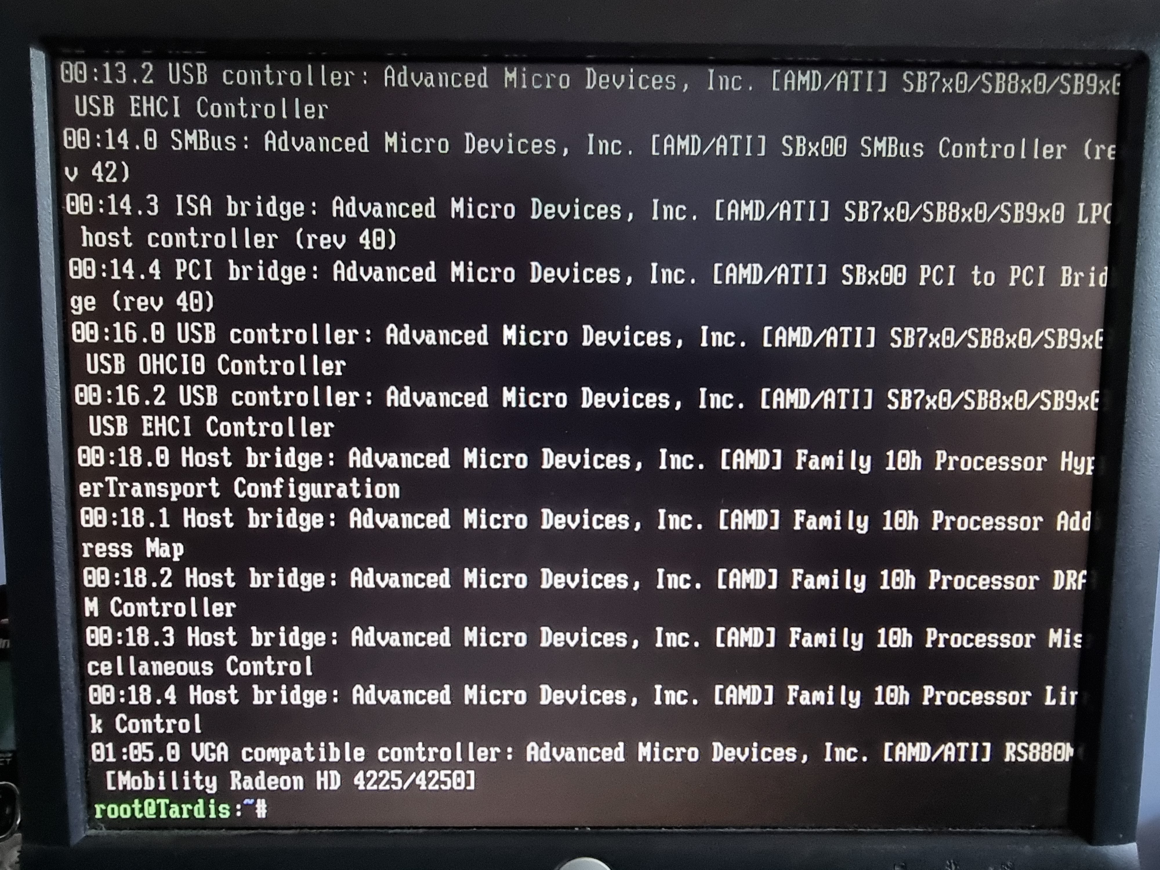

  8. Here are a couple of screen shots of the lspci command output.
  9. For ethtool * I get :- Settings for br0: Supported Ports: [ ] Supported Link Modes: Not reported Supported pause frame use: No Supports auto negotiation: No Supported FEC modes: Not reported Advertised link modes: Not reported Advertised pause frame use: No Advertised auto negotiation: No Advertised FEC modes: Not Reported Speed: Unkown! Duplex: Unknown! (255) Auto-negotiation: Off Port: Other PHYAD: 0 Transceiver: Internal Settings for lo: Link detected: yes Settings for br0: Link detected: yes For lspci I will take a screen shot and post back.

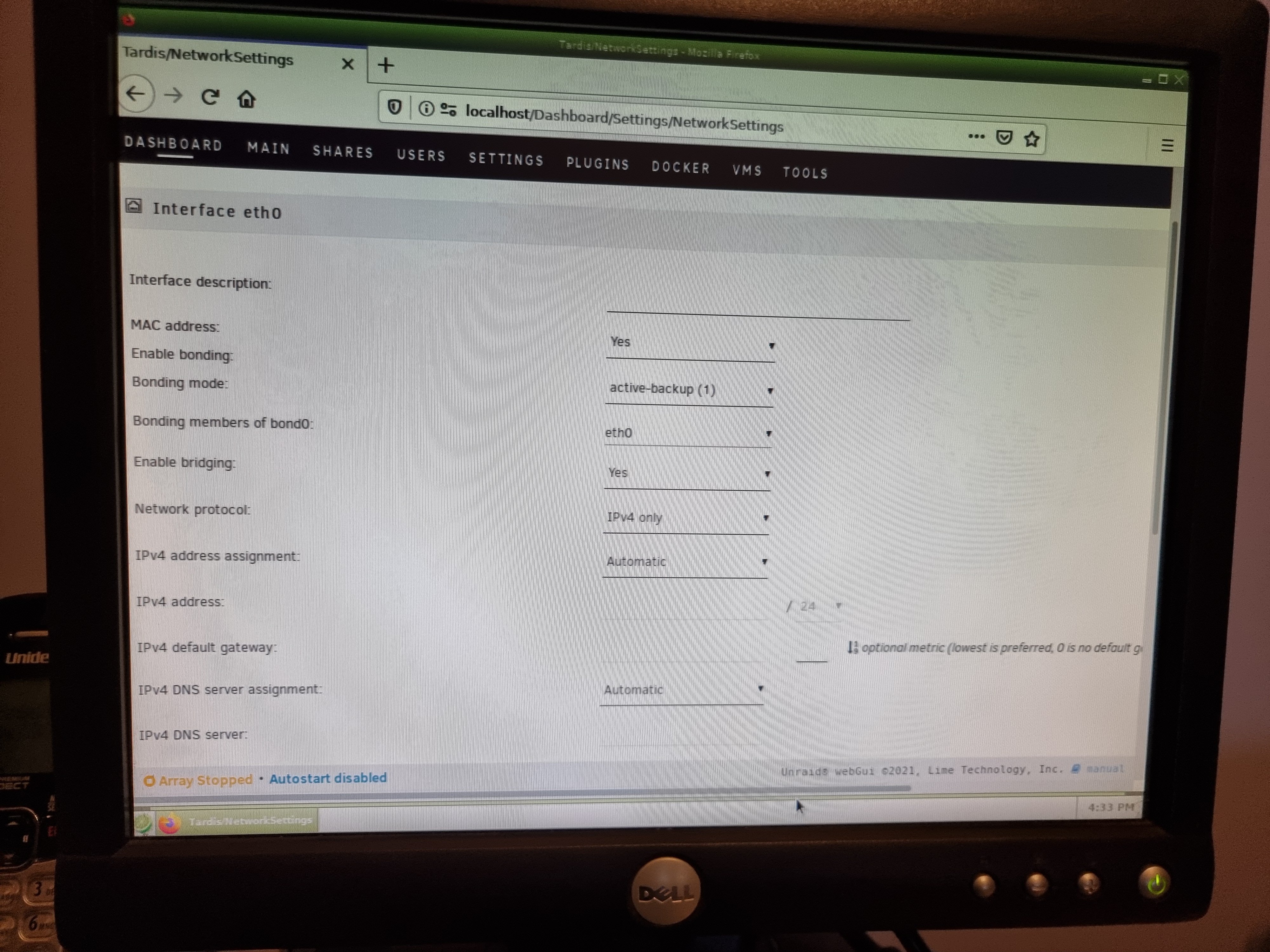

  10. It's listed under the Network Settings, Bonding set to No, Bridging set to Yes. MAC Address not displaying. Network activity light on server not flashing. 2 solid green lights on the port connector.

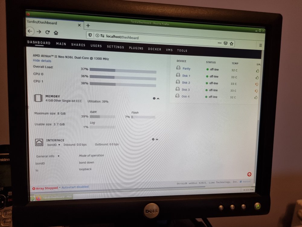

  12. Having trouble getting the network interface running so I can download the community applications plugin. Have tried replicating settings from my other running server but no joy so far. I know the network point on my switch is working as I had a Windows 10 PC plugged into it earlier today. ETA: For some reason I'm only seeing interface "LO" not ETH0 on the Dashboard summary. The server is a HP Microserver N36L with a single ethernet port. Have tried everything but I'm stumped now.
