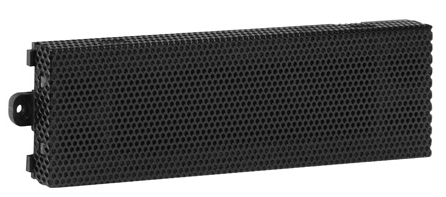

  18. I just realised I never came back to say how I went with the mesh panel. It fits fine with a little bending and twisting, doesn't need anything else to hold it in place too. I have 7 HDDs all running happily in my Tardis now, 6 x 3.5" and 1 x 2.5". Temps are good, the bottom HDD in the double stack running just a few degrees Celsius higher than the rest even during parity checks (have one running right now and temp is 35c, other 6 are 31/32c). The hardest part of getting all the drives in was shoehorning the Nexus DoubleTwin into the ODD rails, don't want to think about having to do that again in a hurry.
  19. I put out a call on the WTB forum of Overclockers AU (OCAU) and a fellow member had one spare. It's from a Coolermaster Elite 3xx series case and as near as I can tell the dimensions match those of the cutout on the Microserver. I don't have it as yet so cant say for sure if it will fit or what it will look like. Can anyone tell me why the status light on my Cache drive in the UnRAID console is flashing green, not solid? I also can't see the temperature of the drive now. NVM, all good now.
