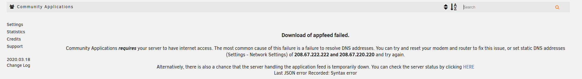

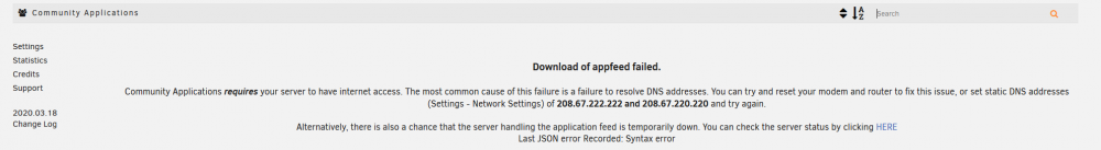

  1. Thank you. I have updated to 6.8.3 as per above. I copied over the config folder except for the network.cfg file. This resolved the DNS issue. However the hang on reboot persists. Also, I was using the Nvidia version of Unraid and I did re-install Nvidia 6.8.3 after upgrading. Happy to upload any logs to resolve the reboot issue. This is a major problem for me as I am self-hosting Nextcloud and need system to come up by itself if I am not home.
  2. Yes. Understand that. Just saying that DNS is being resolved outside of Unraid. No. DNS is set to PfSense as has been for the past 3 years. No changes there and was resolving just fine till a few days ago. This instance of Pfsense is running PfBlockerNG. Also Pfsense is resolving DNS just fine for the backup unraid server as CA is able to reach out. Have also tried swapping the main Pfsense box with an older Pfsense box that I used till a few months ago. Same problem on the old PfSense. Old PfSense not running PFBlockerNG so the problem is with the instance of Unraid on the main server. Something that has developed over the last week. Are there any differences in the *bz files in the current version 6.8.3 to the version I am running - 6.8.0? Also if I were to do a fresh install on a new usb, what files/folders do I need to copy from old flash to new flash to maintain drive and docker settings. Drives are encrypted and have a lot of personal data that I do not want to loose. Thanks.
  3. I can reach the Github page if I click on the "here" hyperlink
  4. Thank you for your reply. I have done this but seems my server has other issues. Don't know whether this forum is the appropriate section or my question needs to be moved to some other forum. Server is running 6.8.0 Issues: Main unraid server not able to reach DNS server (PfblockerNG on Pfsense) even though all other clients on various Vlans and backup Unraid server getting DNS. Main server no longer re-booting. Have to do a hard restart after any change - gets stuck at "Loading /bzroot...ok" Then nothing (see attached) Please advise. Thank you.
