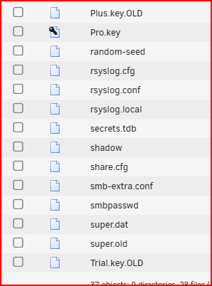

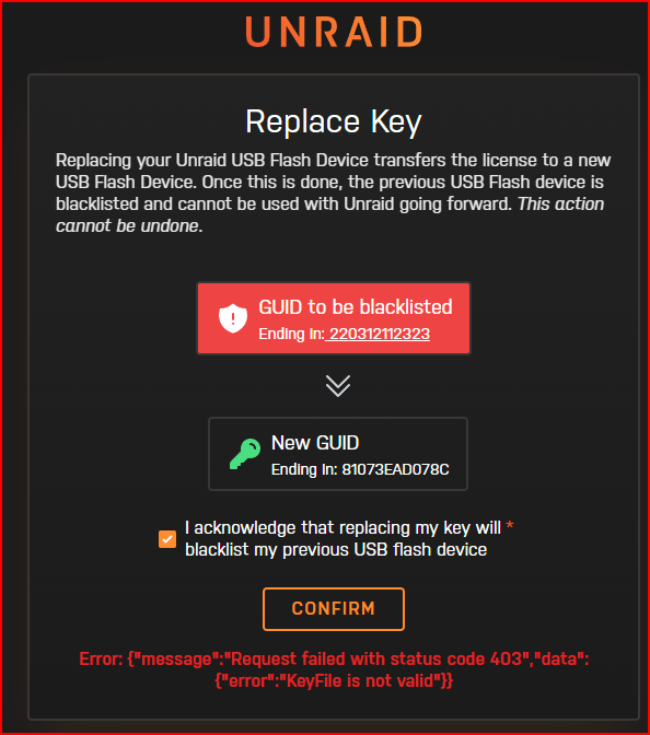

  4. i tried renaming the key and activating again and i get this error.

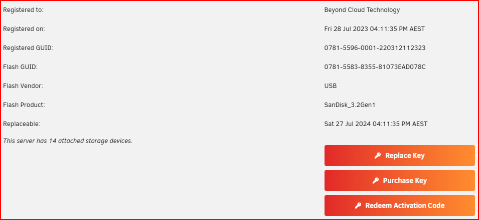

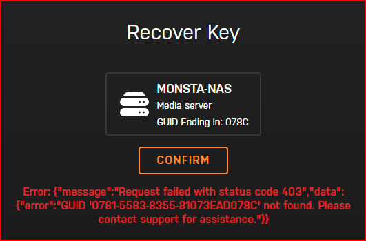

  5. its detecting everything above as it tells you registered to... I clone the drive if I have issues with it. (I have automated backups as well) It worked perfectly fine until I updated to latest version the other day. I think i just need someone to unlock it so i can register the new drive.

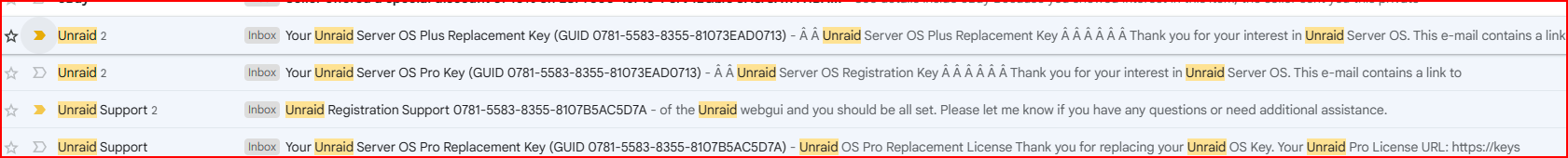

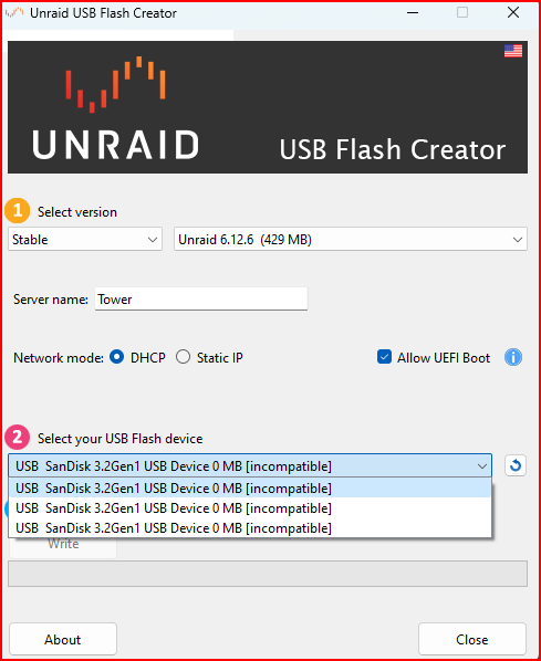

  6. Hi guys This happened few weeks ago but I have been to busy. After the recent update my USB was blacklisted for some reason. As it was USB C I thought I use this chance to also transfer it to a normal USB Drive. I did change to the USB C one about 3 months ago as my main USB Had writing issues. I have about 10 of these drives around the house. When i started again with unraid 1-2 years ago all of these USB Drives were compatible but over time they became useless via the tool so I have been cloning when they break. I did submit a troubleshoot request when the my original key blacklisted that week when latest update came out but I have heard nothing back
