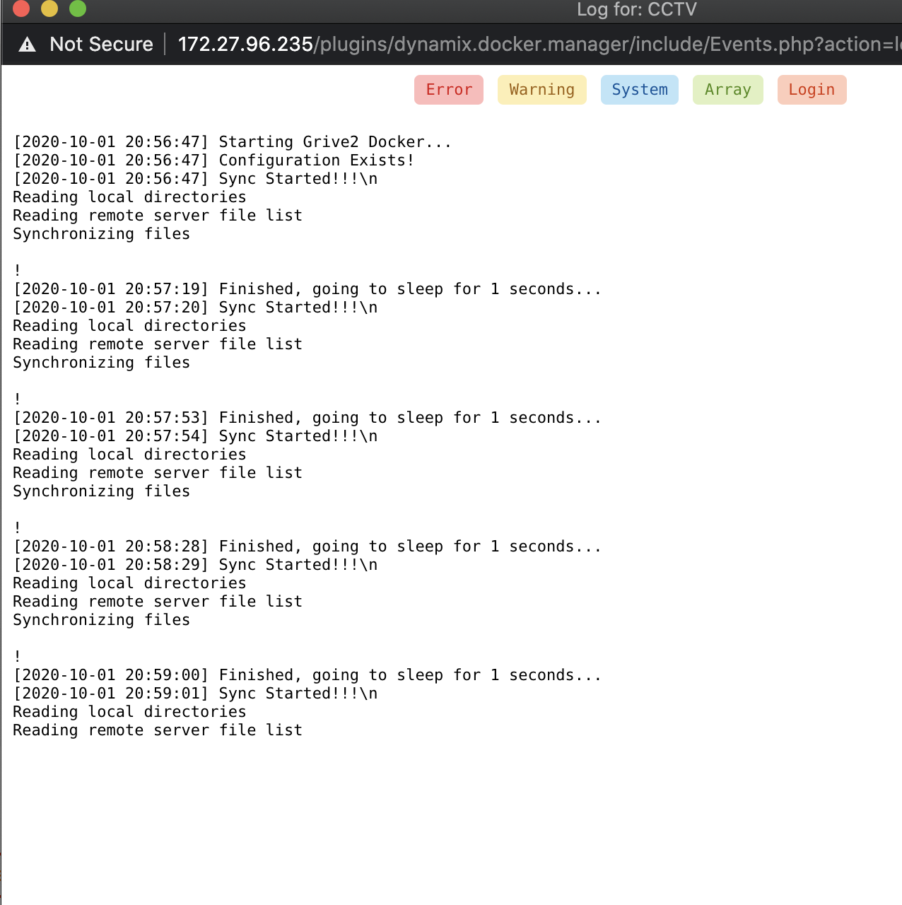

  14. Weird, I tried replicating that. Set an SMB share to private and synced a folder inside the share to a drive folder of the same name and it worked. How did you arrive at that conclusion? Can you give us your Docker container's log output ? also it would help if you try running this inside the folder you are trying to sync and post it here to check permissions. I dont know what I tried but tested it again today and could confirm your issue. I added it as an issue to github will be dealing with that soon.
