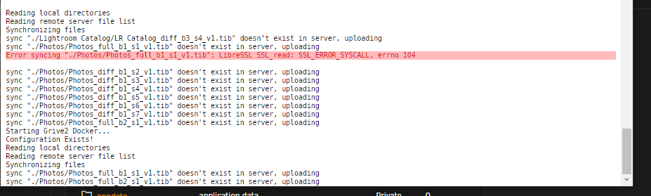

DTMHibbert Posted October 1, 2020 Share Posted October 1, 2020 Sorry, what i mean is when i look at the log file, from the unraid dashboard (picture attached) there is no time/ date of when specific actions took place. In the image attached there is an error highlighted in red - it would useful to see what time/ date this was so i could narrow down what possibly caused it. it would be also helpful to see when certain files were started uploading to see how long they took to upload. Thanks Quote Link to comment
agusalex Posted October 2, 2020 Author Share Posted October 2, 2020 Sure thing! update to latest version (1.2 or latest tag) couldn't manage to add that to Grive itself but to it's runs so that should give you a range on which time the error might have occurred! (Also thanks to victorkp we now have sleep time as a parameter to avoid high CPU usage all the time ) Quote Link to comment
