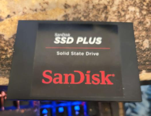

  5. sad to say this little bastard is culprit and lasted a long time in service to me. when I swapped and plugged this boy into sata the ASUS stopped at A2 and had same odd bios issues. This guy prevented me from bios and tricked me. But I had some issues with asrock so I am at peace with my new used ASUS ROG X570-Gaming E. Live and learn , gonna have to reset my cache and im gonna just reset all my disks.

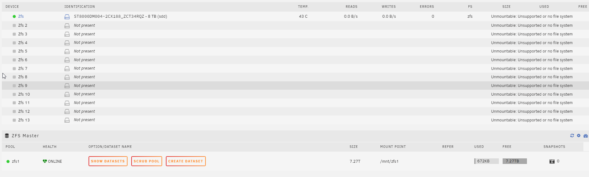

  12. If I put this one disk in array as zfs would it work with unraid without a format? I did zpool create -m /mnt/zfs1 zfs1 sdd forget everything I been saying I am all good now. Simple question off topic. I got a EVGA 650 watt PSU I think I need upgrade or swap to better one I have 13 HDDS + 3 SSDS and a 1080 TI AMD Ryzen. Is that enough power?
  13. you cannot expand a raidz pool with a single disk (at least not for now), you can add another vdev of the same width, say for example you have a 4 disk raidz1 pool, you can add another 4 disks in raidz1 to expand it Its not soon for the pool to add same vdev thing huh? I can have ZFS compression on the array right and other features except performance and self healing.. What about my XFS disks can I make a 2nd pool and them like an array to move data? Last question if you where in my spot would you move to ZFS or stay XFS. Is ZFS so great that I should move? If I go ZFS array in future can I make a a ZFS RAID Z with same data?
  14. So it would be ZFS array with no RAIDZ right but with FS features of ZFS ? So XFS < ZFS Can I pool my XFS disks so I have small ZFS array and XFS pool?
  15. Ok wait can I put all my disks as unassigned and move all data to zfs array one by one? Can I swap my array with a pool ? can I have a pool of xfs?
