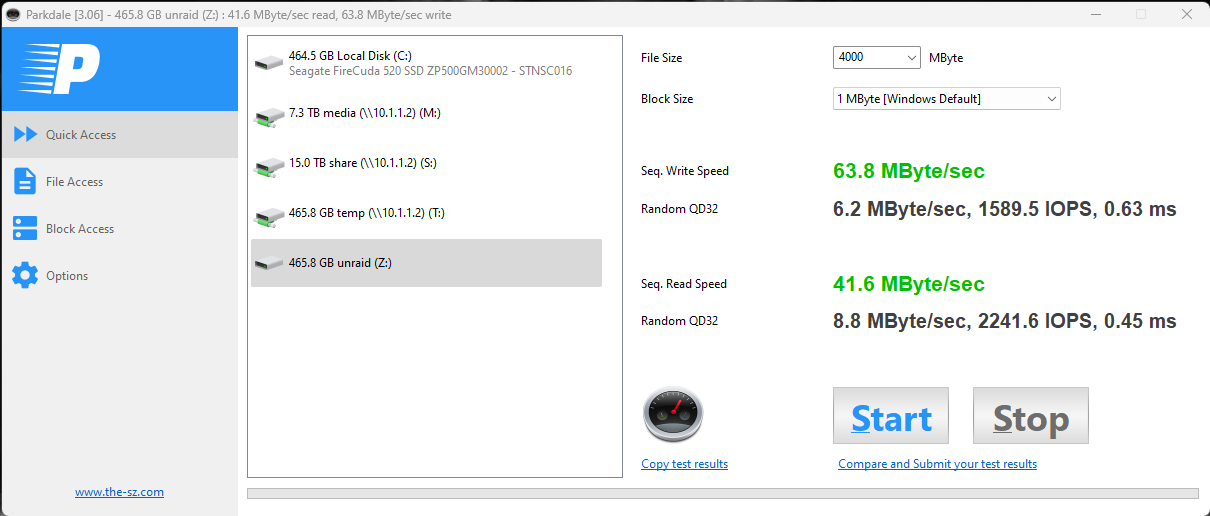

I'm getting bad VM performance over all when Virtio-FS is setup.
Other then the Windows VM freeze issue, I first noticed stutter just using the VM browsing web sites.  and then I noticed games run horriably and becomes unplayable.
so I figure I should do some testing and see if virtio-fs is really better then samba share and I was expecting it to be so, but the finding is interesting.

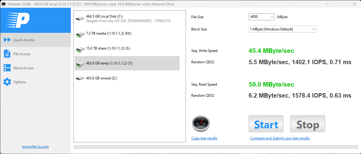

I did two speed test using parkdale while i have virtio-fs setup.
First testing the speed to a share through samba
then test the speed to the same folder through virtio-fs.

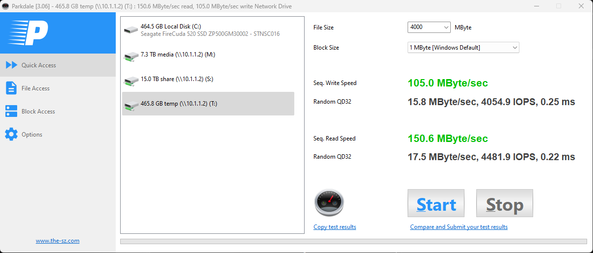

Lastly, I removed virtio-fs setup and did another test on the same share over samba.
Overall VM performance is so much better without virtio-fs configured and even samba share are faster.  I thought I'm suppose to get "like passthrough" performance using virio-fs.
Am I missing something or doing something wrong?

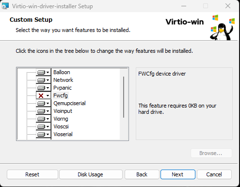

I'm testing Virtiofs on my main Win11 VM, and having quite some success, but with a few caveats.
Firstly, while installing the latest virtio drivers, my VM IMMEDIATELY CRASHES.
I found through lots of trial and crashes that if I leave "Fwcfg" DISABLED, the install finishes.
Disabling it allows install of updated drivers, sets up services, and does not crash the VM.
What is this Fwcfg, can anyone shed some light on that?

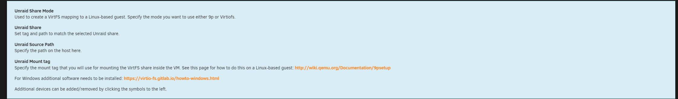

Fixed for Windows was only showing for non Windows and added additional info.
