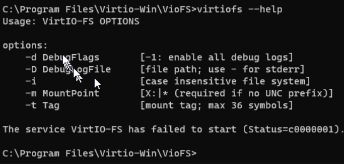

Hello, I've been trying to mount multiple shared folders in my Windows 11 VM with no luck. I tried to do the following.
C:\Windows\System32>"C:\Program Files (x86)\WinFsp\bin\launchctl-x64.exe" start virtiofs viofsY mount_tag T:
KO launcher: error 183
I am not sure you can use that method if you want multiple.
Maybe create a batch file and run as a startup. it would be virtiofsd -m z: -t mounttagname

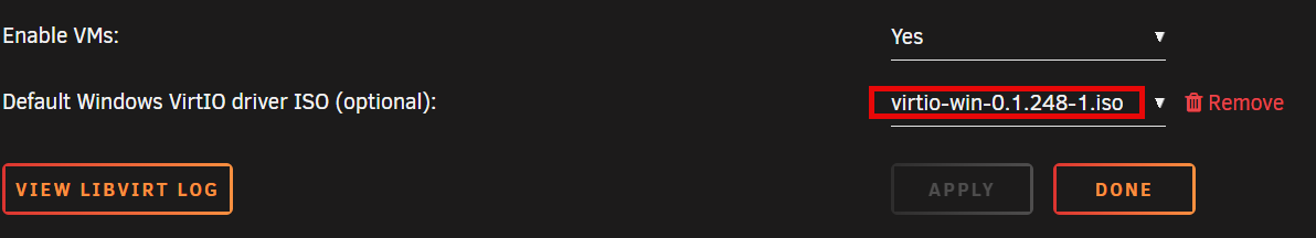

VirtioFS under Windows is now stable as of Unraid 6.12.5 (QEMU 7.2) and Virtio Drivers 0.1.248-1. Ensure you install this driver or later as well as Unraid 6.12.5 or later. Earlier versions of Unraid will cause the VM to lock up and earlier drivers have an issue where any filesystem IO will cause a large non-Paged pool memory leak.
Go to Settings  -> VM Manager to grab the latest Virtio Windows drivers.

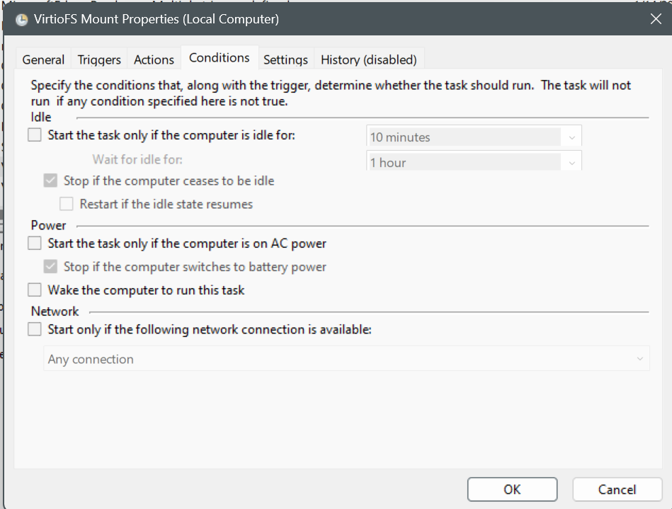

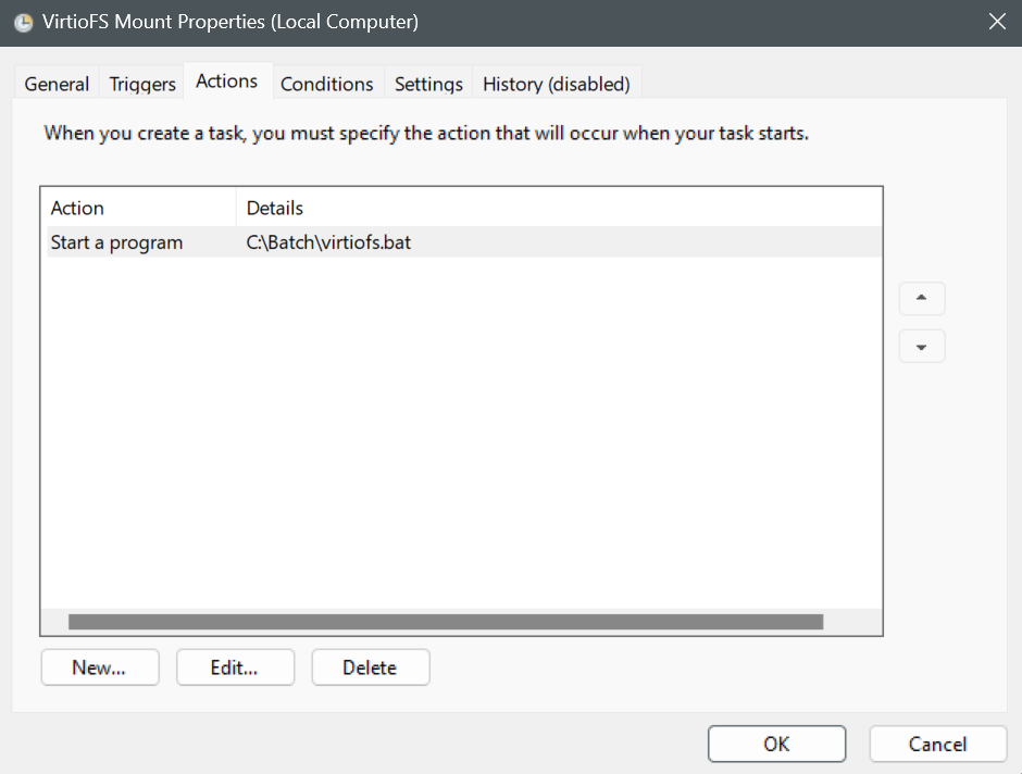

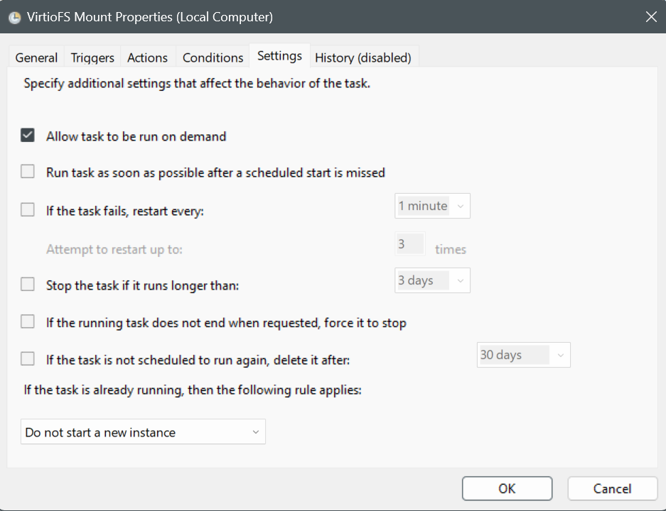

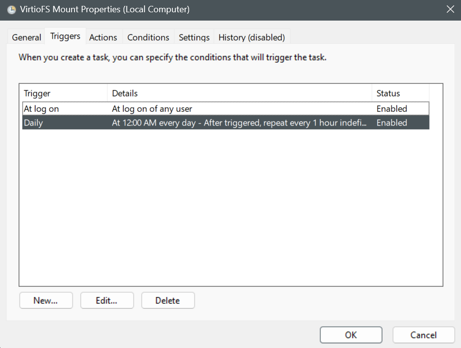

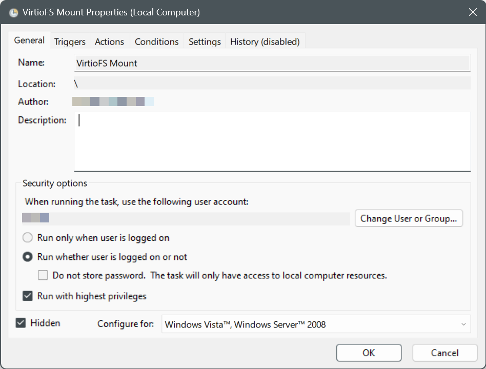

For running the mount script I prefer to set up a scheduled task in Task Scheduler as follows:
Where C:\Batch\virtiofs.bat is your mount script.

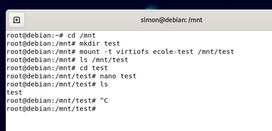

22 minutes ago, 30zal said:
So, I tried mounting my drives in an Arch VM following this guide https://blog.siglerdev.us/setup-unraidos-virtual-machine-with-virtiofs-share/ .
All the mount points that I put in give a "mount point does not exist" error, not sure what to do since little information seems to be available on how to set it up for Linux.
You need to create a mount point in linux. https://docs.kernel.org/filesystems/virtiofs.html

On Debian VM
root@computenode:~# cd /mnt/user/ecole-test/
root@computenode:/mnt/user/ecole-test# ls
test
root@computenode:/mnt/user/ecole-test# cat test
Test
