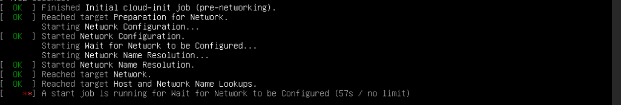

If I try to add virtiofs/9p to an existing ubuntu VM it hangs here for a few minutes;
It does eventually boot but the network doesn't come up. I can mount the passed through directory from within the guest but networking is dead. If I manually bring the interface up it doesn't get an IP address.
If I remove virtiofs from the VM config it goes back to normal and networking works. Any ideas?
I have tried Debian and Ubuntu and cannot reproduce an error. Can you post diagnostics.

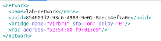

Looks like you are using  virbr1 which will nat. any reason why you are not using vhost or bridge interface depending on your config?
<interface type="bridge">
<mac address="XX"/>
<source bridge="virbr1"/>
<model type="virtio-net"/>
<address type="pci" domain="0x0000" bus="0x01" slot="0x00" function="0x0"/>
</interface>
<mac address="XX"/>
</interface>
virbr1 is a bridge I created to connect VM's directly to my pfSense VM, there shouldn't be any NAT. This is it's definition;
The CasaOS VM connects to the pfSense VM through this so I can firewall it and keep it off my main network.
To eliminate that being the problem I've moved the VM to vhost0 and still get the same. It was using a static IP but I've changed it to DHCP so I can switch between networks, without virtiofs it gets an IP and connectivity, enabling virtiofs in the config kills the guest's networking.

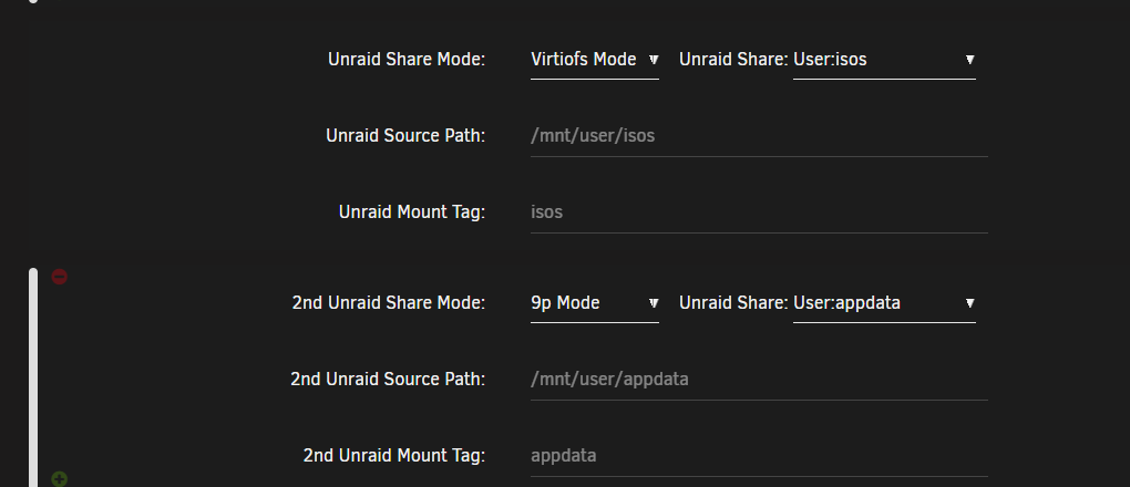

Edit: I've fixed it. Enabling virtiofs changes the network interface name, it was enp1s0 when I use virtiofs it gets changed to enp3s0. Working now.

Mount type will depend on template setting.
Thanks, pretty sure I chose virtiofs but I've enabled/disabled it so many times troubleshooting it I must have picked 9p by mistake.

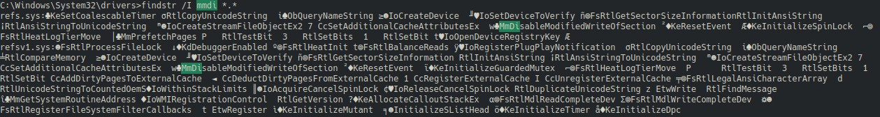

I decided to give virtiofs another go since its been awhile and I have since upgraded to Windows 11. I noticed that while directory listings are faster than samba shares, the transfer speed is pretty bad. I can only get about 50 megabytes/second. Is there any configuration change I can try to improve performance?
On 4/29/2023 at 11:25 AM, mackid1993 said:
I also want to draw attention to this Reddit post. I observed the exact same issue described with the non paged pool leak. I used poolmon to track it down and it pointed to refs.sys. The non paged pool will just slowly grow and grow until the VM runs out of memory.
Oh cool, someone actually read my reddit post.  It would have been even cooler if one of you guys had left a comment linking back to this thread for further discussion 😀.  So here we are 7 months later, I have more data to share.

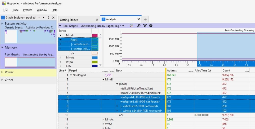

I am 99% sure this has nothing to do with refs.sys.  If you do a case-insensitive search for mmdi you will see the actual string it finds in refs.sys: MmDisableModifiedWriteOfSection.  So it's not really a match to that pool name.
There's a thread on superuser that describes more methods for hunting down these non-paged pool leaks.   Note where it says:
If the pooltag only shows Windows drivers or is listed in the pooltag.txt ("C:\Program Files (x86)\Windows Kits\8.1\Debuggers\x64\triage\pooltag.txt")
you have use xperf to trace what causes the usage.
Mmdi is found in pooltag.txt so you actually have to use xperf and wpa for further debug.  Following the method described there, I captured a snapshot of memory growth, opened it in wpa, loaded symbols, and expanded the Mmdi pool to find stack references to winfsp-x64.dll and virtiofs.exe.  So there's the smoking gun, one of these drivers is the culprit.

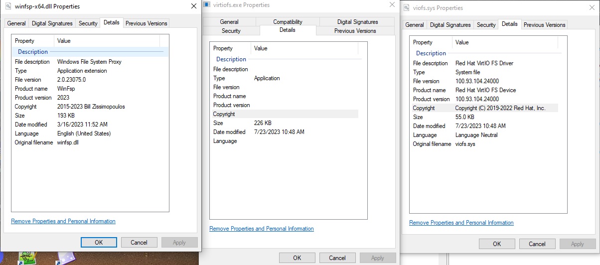

I upgraded to the latest versions of WinFSP (2.0) and Virtio-win guest tools (0.1.240) and the leak is still active.

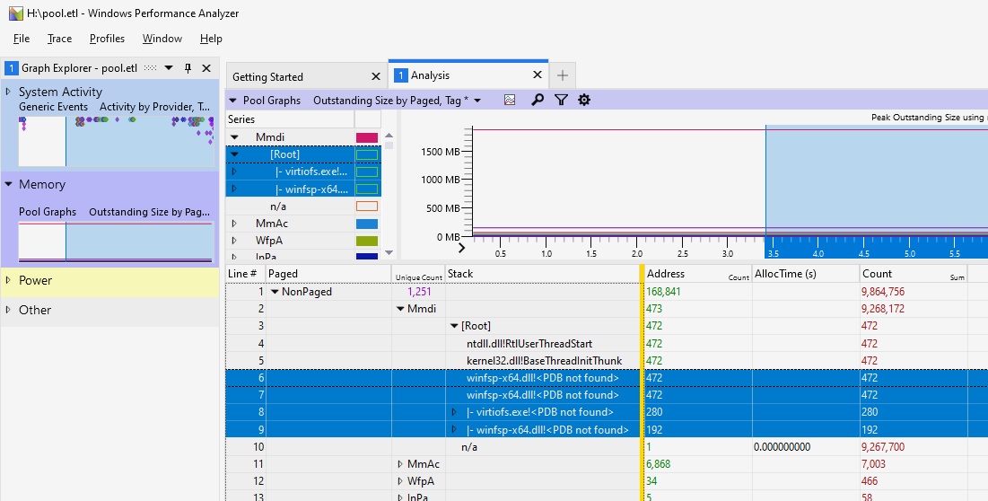

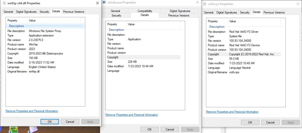

So it's probably not the driver per-se but something on the QEMU end.
