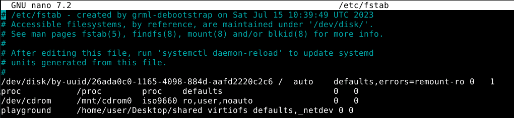

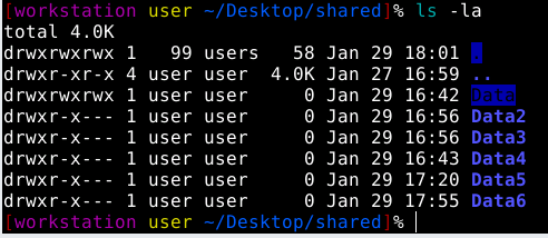

Hi there,
i got some trouble with permissions with using Virtiofs in a Linux VM machine.
The VM (called workstation) is created with virtiofs and i was able to mount the share on the linux machine without any trouble and added it to fstab to make it permament.
VM:
fstab on client linux machine:
But whenever i create a new folder or file in the mounted directory "shared" on the linux machine, it is created with the wrong user permissions.
On the host they are translated into another user
Is there a way to set other default permissions (in the fstab?), whenever something is created in the mounted folder?
Security is not relevant in this case so 777 would be ok.
Any help is highly appreciated!
Edited by Jabberwocky
For everybody running into a similar problem: The fstab will not accept any further changes with gid/uid/umask for the virtiofs entry but i was able to change the "umask" setting in the VM itself so it is working fine, now.

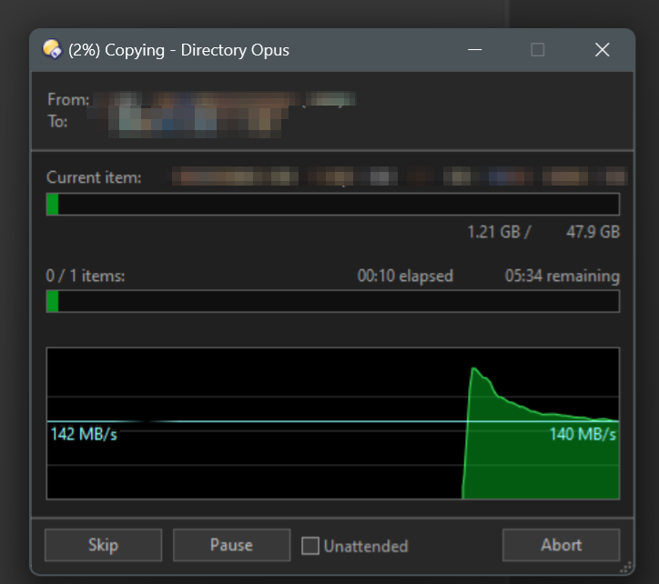

I'm trying out the new drivers to see if the VM freeze issue is resolved. However... is there a way to make the performance any better? Directory listings with tens of thousands of files are significantly faster than smb shares, but actual transfer speeds are terrible. I am getting about 45 MB/s with virtiofs vs 275 MB/s with samba shares.
Do I have something misconfigured? I don't understand all the hype over virtiofs if this kind of performance is normal.
Have you tried replacing the virtiofsd with newer rust version as the qemu has been removed aftern7.2
https://gitlab.com/virtio-fs/virtiofsd/-/releases
Yes I have - The rust version made no significant difference. Speeds are still 45-60 MB/s. On the plus side, the VM seems stable and hasn't locked up with the 100% cpu utilization issue.

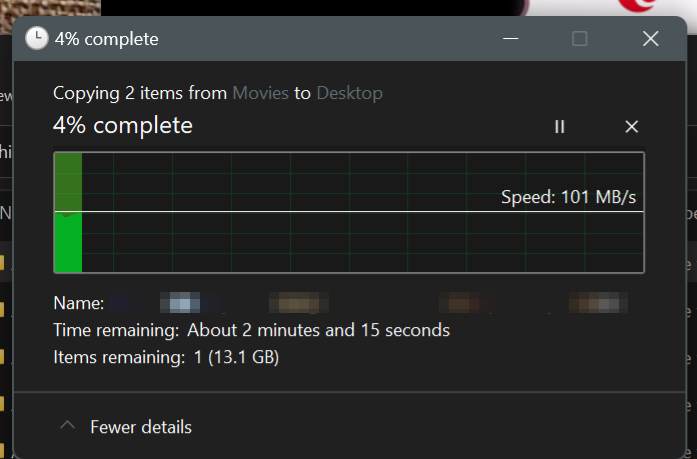

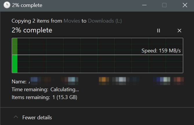

I don't have this issue. This is a transfer from my Unraid array to the nvme drive that my VM boots from. I get similar results with a share to share transfer as well. 100 + MB/s
Edited by mackid1993
Same results using Windows native file copy.
Share -> VM Desktop (nvme drive)
Share to Share
changed file for share to share bec of caching

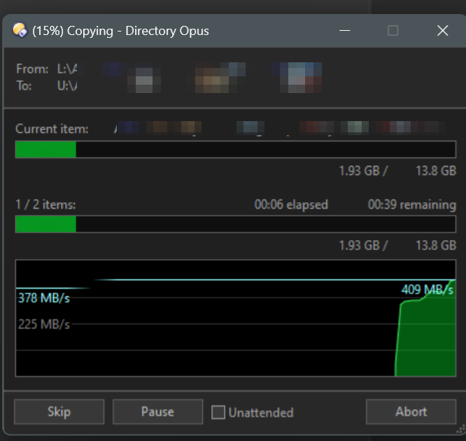

@mackid1993 - Thanks for sharing. Your speeds are much better than mine, but still pretty poor compared to SMB. Were you transferring to/from spinning disks or from an SSD cache pool to your to VM? I'm curious what speeds you get between a fast unraid cache drive and your VM.
This was spinning disks to NVME. NVME to NVME would be much quicker. What version of WinFSP are you on?
@johnsancThis is transferring a file that was on nvme cache on one share to nvme cache on a different share. I think something is wrong with your setup honestly.
