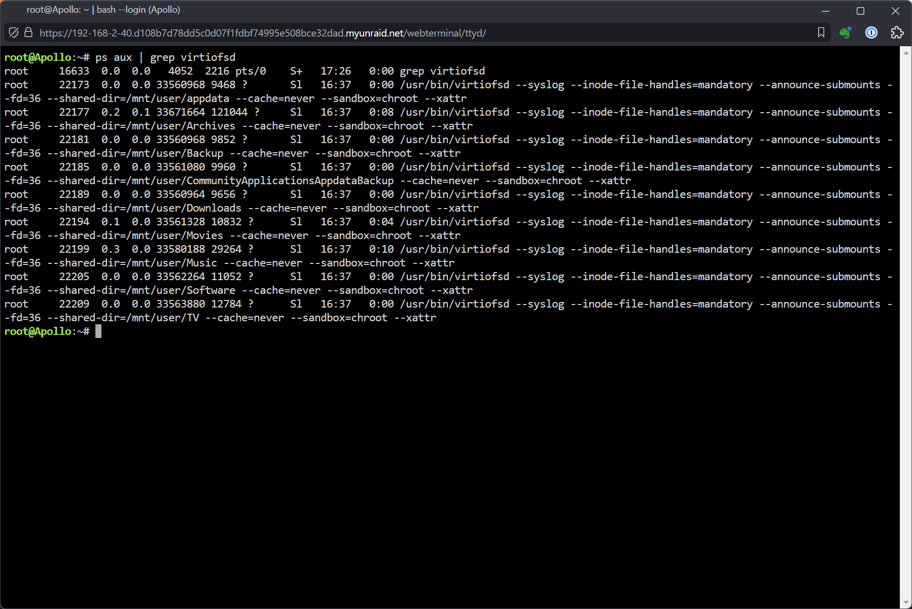

    I was able to run Virtiofsd with the --inode-file-handles=mandatory switch. I created a script:   #!/bin/sh exec /usr/libexec/virtiofsd --inode-file-handles=mandatory -o sandbox=chroot "$@"

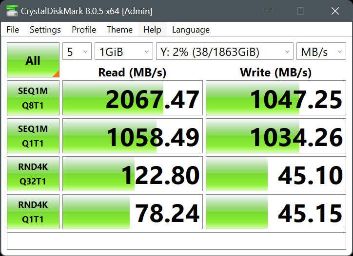

I'm seeing over 200 MB/s reading from my array and deepening on the transfer 600 - 800 MB/s nvme to nvme. SMB can get faster with nvme but no network overhead is nice.
So performance isn't great for nvme, this is crystal disk mark on my appdata share which is a Samsung 980 Pro. It's clearly not optimized for speed. It can certainly saturate an Unraid array though.
Edited by mackid1993
added nvme benchmarks

I shared a crystal disk mark of my nvme, scroll up one post. It's not comparable to baremetal or nvme passthrough but it's fast enough for most use cases and will certainly max out an unraid array. Virtiofs (at least on Windows) is not optimized for performance, this is per the virtio-win devs.
