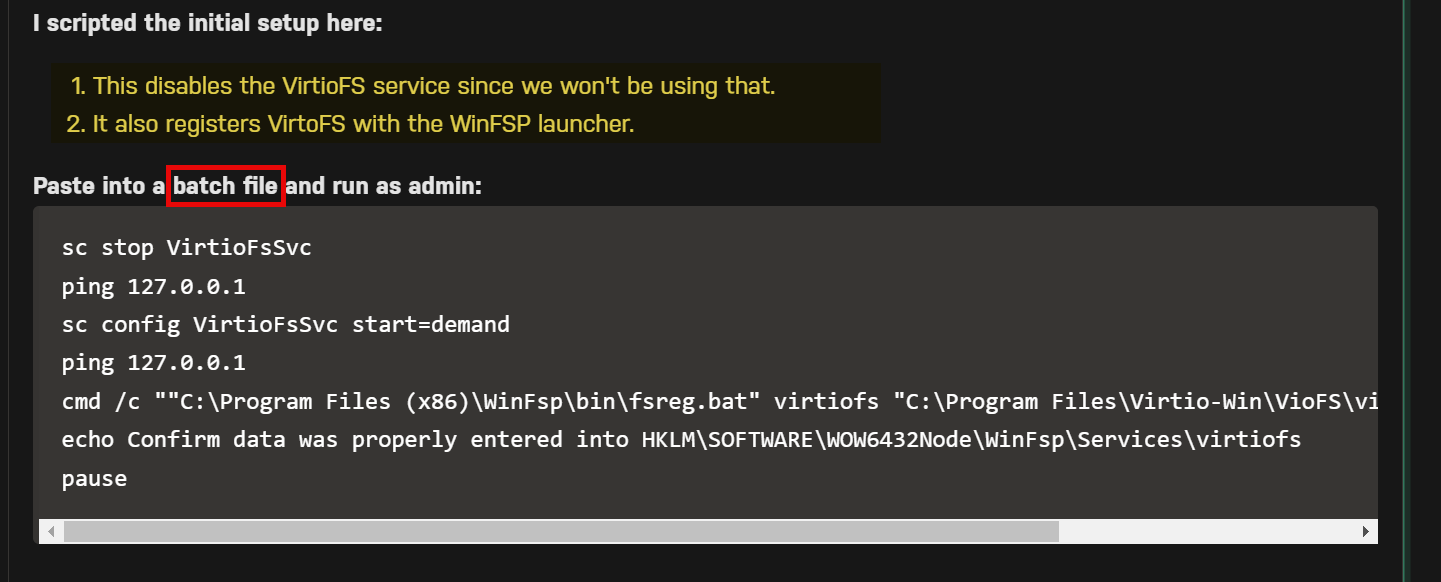

First, installed winfsp-2.0.23075.msi
Rebooted.
Ran batch file 1 as seen below:
sc stop VirtioFsSvc
ping 127.0.0.1
sc config VirtioFsSvc start=demand
ping 127.0.0.1
cmd /c ""C:\Program Files (x86)\WinFsp\bin\fsreg.bat" virtiofs "C:\Program Files\Virtio-Win\VioFS\virtiofs.exe" "-t %%1 -m %%2""
echo Confirm data was properly entered into HKLM\SOFTWARE\WOW6432Node\WinFsp\Services\virtiofs
pause

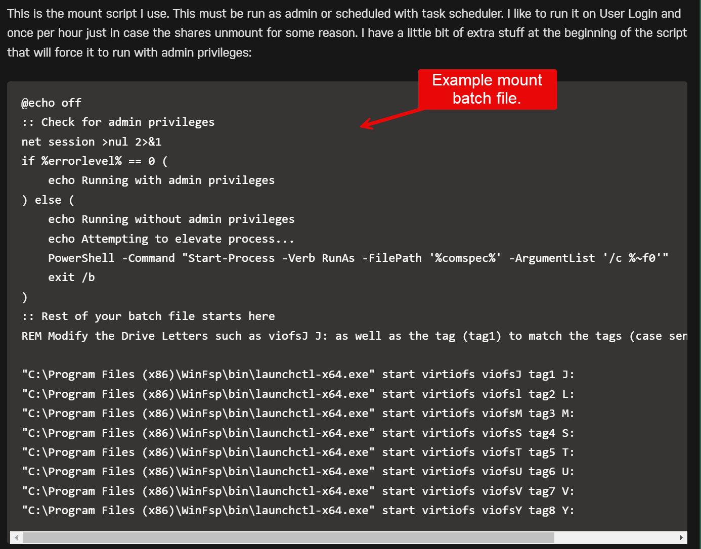

Configured below batch file and ran as admin:
@echo off
:: Check for admin privileges
net session >nul 2>&1
if %errorlevel% == 0 (
    echo Running with admin privileges
) else (
    echo Running without admin privileges
    echo Attempting to elevate process...
    PowerShell -Command "Start-Process -Verb RunAs -FilePath '%comspec%' -ArgumentList '/c %~f0'"
    exit /b
:: Rest of your batch file starts here
REM Modify the Drive Letters such as viofsJ J: as well as the tag (tag1) to match the tags (case senstive) set in Unraid.
"C:\Program Files (x86)\WinFsp\bin\launchctl-x64.exe" start virtiofs viofsJ public J:
public case is accurate to the array share.
First time it runs, nothing happens.
Second time i run it, KO launcher: Error 183
Would appreciate advice on what i messed up.
