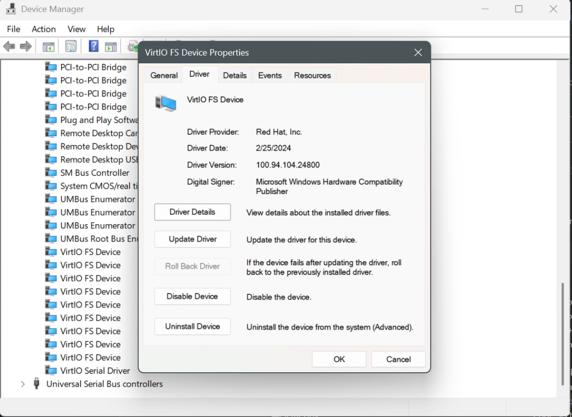

.248 Virtio drivers. WinFSP 2.0.23075.
Maybe go into device manager and make sure the Virtiofs device is not using an older driver sitting in the driver store. I've seen that before.
Edited by mackid1993

Now I noticed, all folders in my VM, including ones I've just created in Desktop, have partial "read-only" flag. Same behavior can be seen in SpaceinvaderOne's video on 08:43. And as long as software I need works perfectly with VM's internal drive, readonly flags are not the issue. Looks like it just doesn't work this way
Thank you for your attention 🙂
Edited by kek_tigra
Additions
Any chance there is a setup guide for an idiot to make this work?
I've read so much and i have no idea how to make this work.
