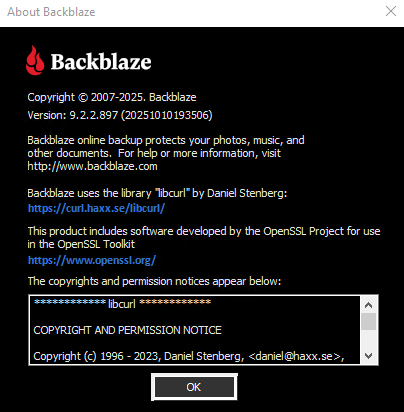

Came here to seek help and found out that it's not only me. What version is your Backblaze? Mine is below.
Edited by HHUBS
I tried installing version 887, then restored my backup state. I haven't got it working again. It seems to have auto updated the control panel as soon as I restarted the computer. I cannot figure out how to turn off auto updates on the control panel software. Any ideas?

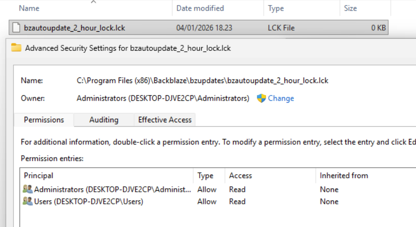

Well a real fix a havent found, but a work around that stops auto update is working for me, there is a file called bzautoupdate_2_hour_lock.lck if you change permission on that file to Read (remember to remove Inheritance) then Backblace service cant dele the file when its 2 hours old and the auto update will never run )
