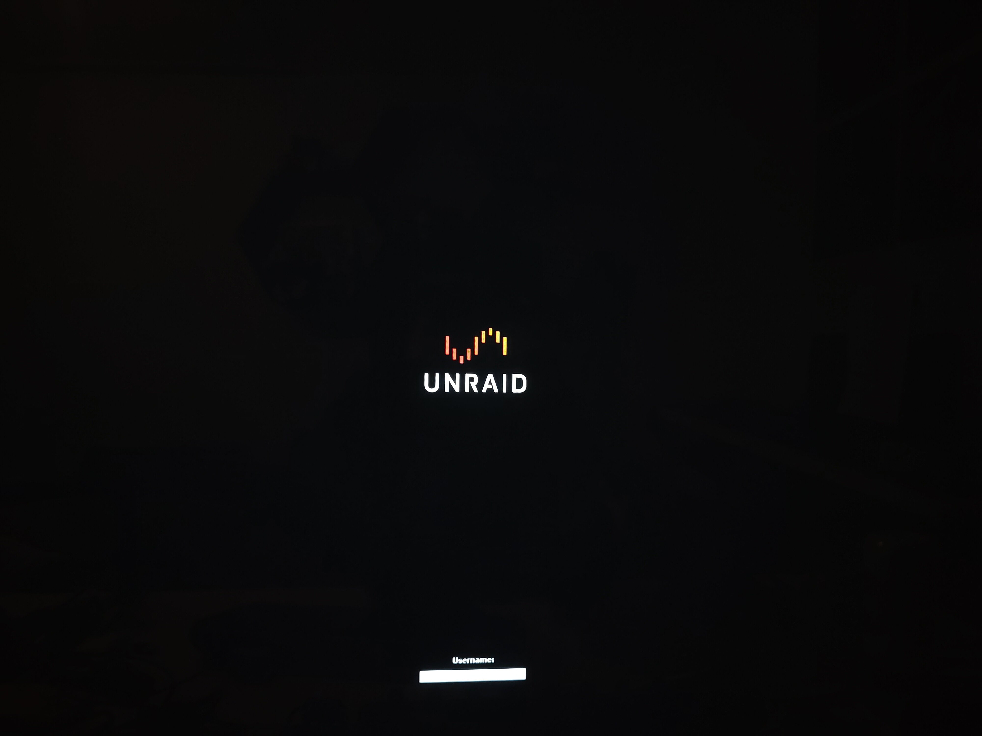

This issue keeps happening to me. No clear pattern. And this time no docker appears to function. Sometimes the server reaches an uptime of almost a month, sometimes it lasts less than a week. I plugged a HDMI display to check if something was displayed. It shows a GUI login screen but I cannot interact with it with a plugged keyboard. Also, the HDD LED light of the case is flashing at regular intervals of 500 ms. Any idea on what I can do to diagnose this? I have like 40 dockers in this server. Running in safe mode with all dockers disabled and start them one by one each month will take years. And most of those dockers I use daily. These are the last 2 hours of logs as received on my other server: You can see there that the last entry happened at Jan 12 07:37:36. An user of my Plex confirms that they were using it at 08:25.
