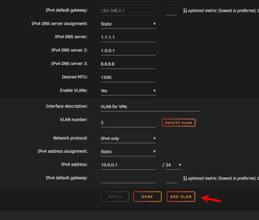

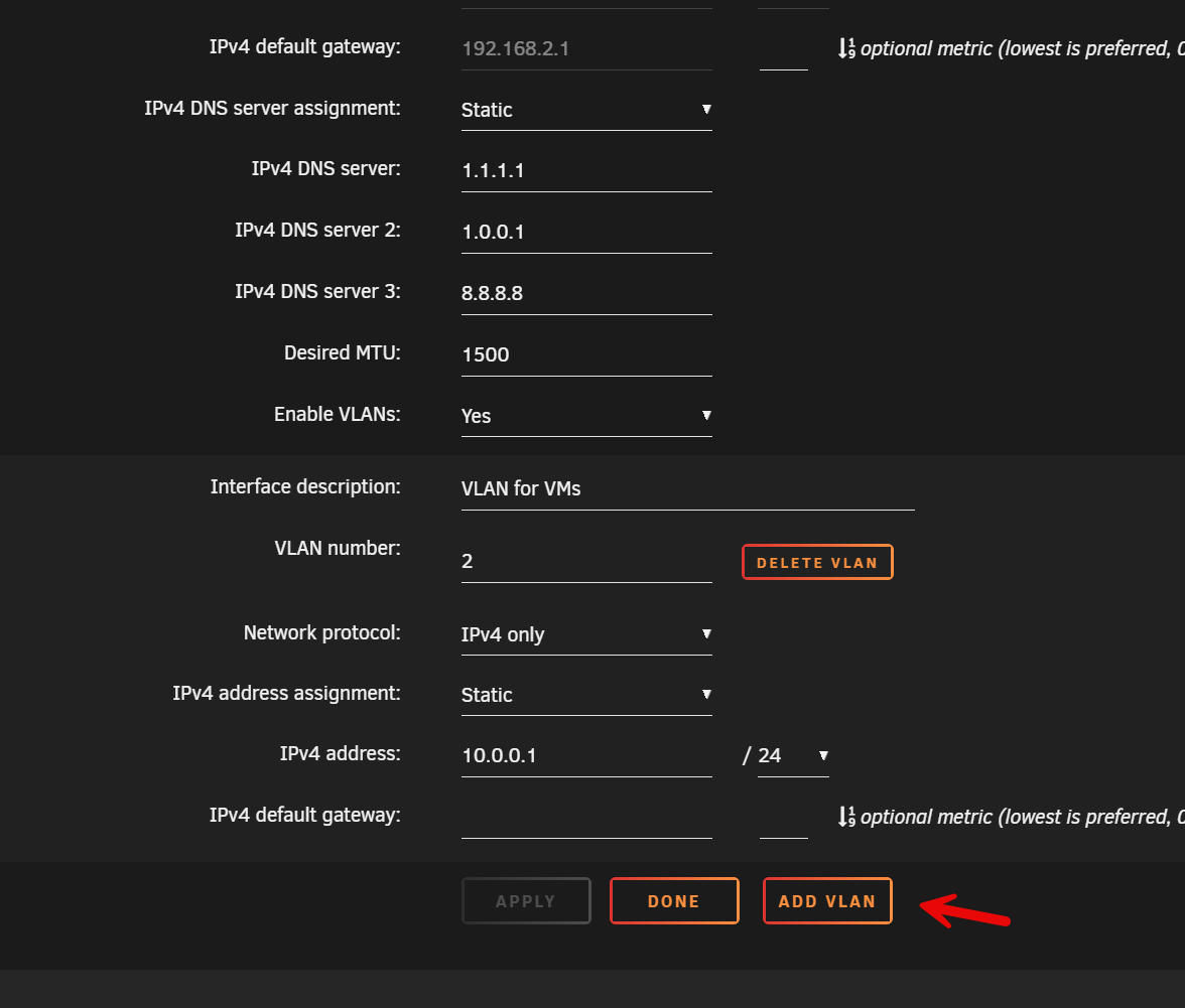

1. Stop the VM and Docker service.
2. Go to Settings -> Network Settings

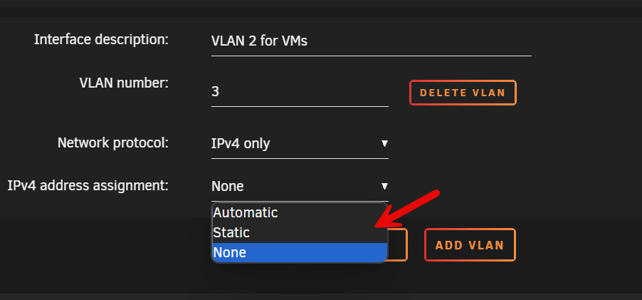

3. Click add VLAN
4. Fill it out and click apply. I already have mine set up so my VLAN number for this example is 3, yours will be 2.

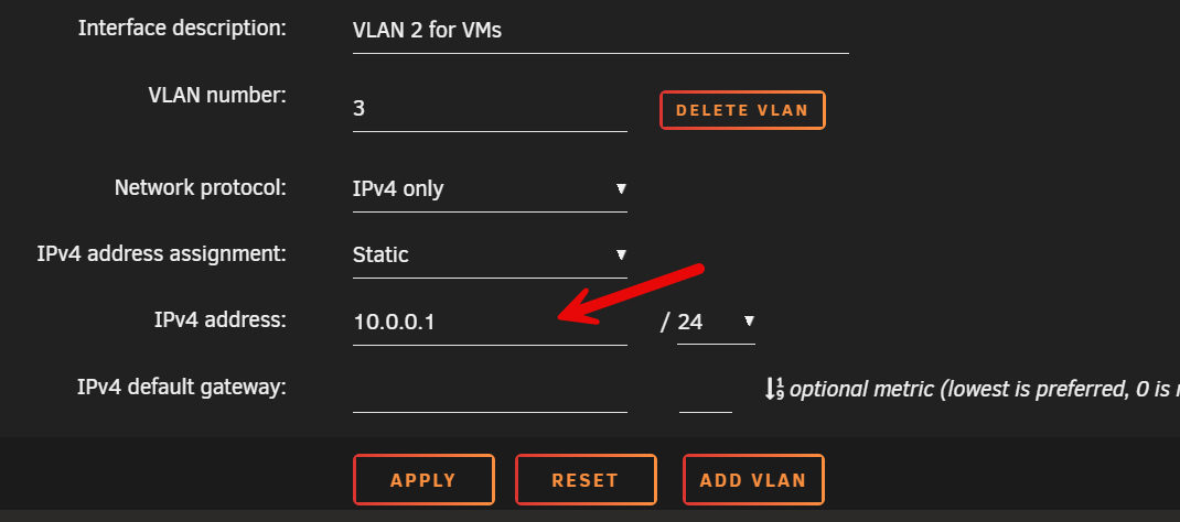

5. Change iP address assignment to static:
6. Enter 10.0.0.1 this will be the address of your Unraid server on the VLAN. Click apply

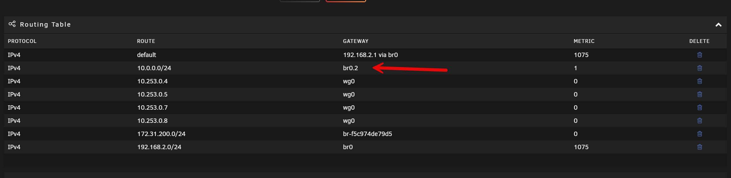

7. Scroll down and find your gateway, likely br0.2
8. Start VM and Docker back up.

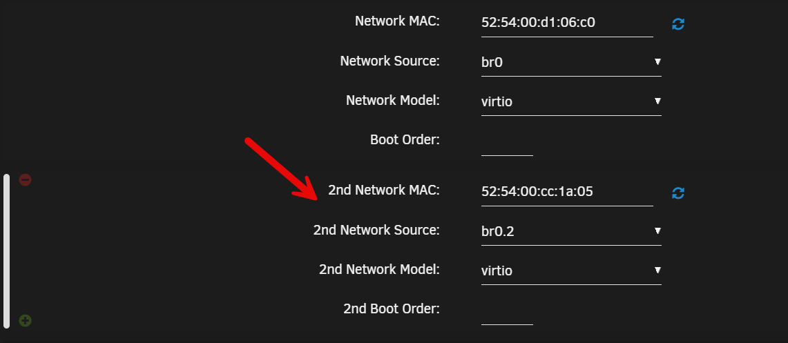

9. Edit your VM template. Scroll to the bottom and add a second NIC. Set it to virtio and the second network source to your gateway likely br0.2.

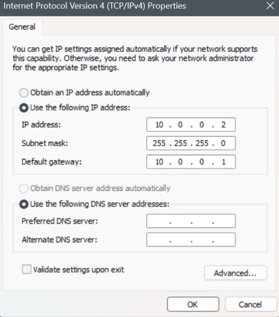

10. Start your VM, open a run dialog in Windows and type ncpa.cpl. Find your new NIC that doesn't have an IP address and give it one as follows. Just check IP addresses to make sure you don't set a static address on your main NIC.
Now your server can be accessed over the VLAN from \\10.0.0.1. However when a lot of activity is happening since SMB is single threaded other applications will slow down. To work around this, I create hosts file entries for each application I use and authenticate separately for each one.

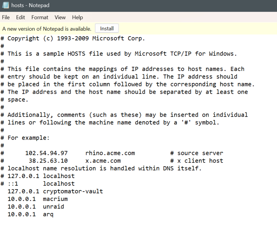

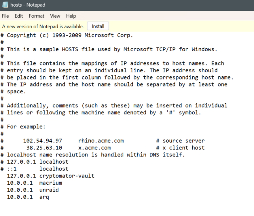

Open an admin command prompt and type: notepad c:\windows\system32\drivers\etc\hosts
These are my entries but you can make as many as you like.
Once this is done in Macrium you connect using \\macrium\share and then your Macrium traffic will stay completely within your server and you can avoid any compatibility issues related to Virtiofs and instead use Virtiofs in situations where it works best.

2 hours ago, mackid1993 said:
@wacko37
3. Click add VLAN
These are my entries but you can make as many as your like.
