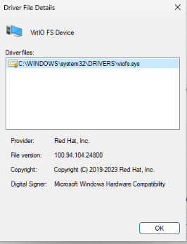

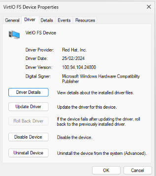

Out of curiosity, is there a general availability release of the patched drivers yet? Or still beta only?
Edited by dmrichards26
typo
Only test drivers released so far.
New drivers released a few days ago.
mm268/build 248
mm268/build 248
Thanks for this Simon. Everything is looking good on these drivers.
I updated my setup post here:
with information about the latest drivers. I added and cleaned up some screenshots as well.
Hopefully now that this is reliable this post can help some more people get up and running with VirtioFS.

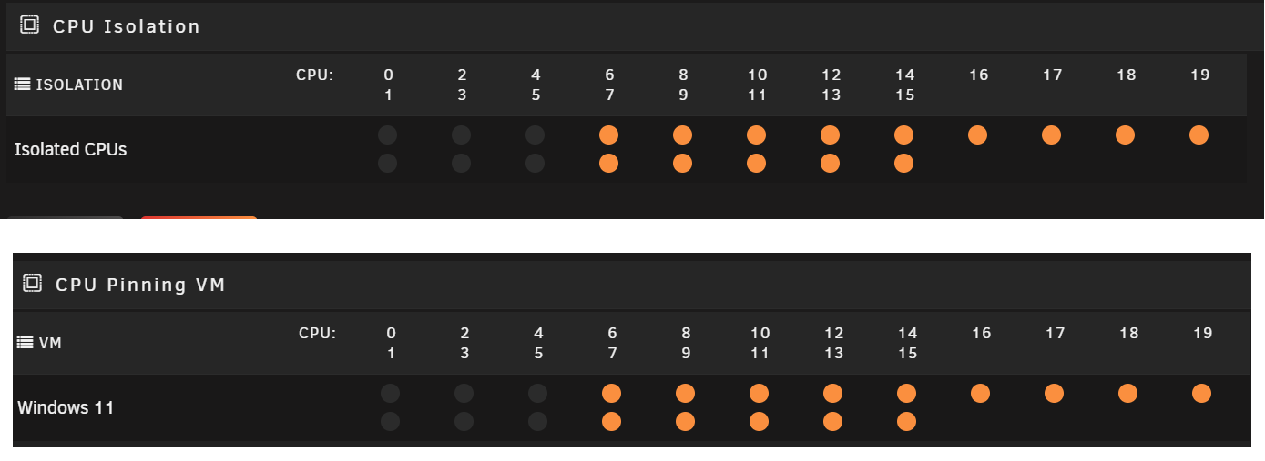

I found that isolating a bunch of CPU threads for my VM has drastically improved performance. Do you have any isolation or pinning configured?
I have a 12700k. I ended up giving Unraid and dockers the first 6 threads and isolated the rest for my VM.

OK so I tried adjusting my CPU isolation and pinning and I got the speed up 60 MiB/s consistently now by shifting all the CPUs for the VM to higher numbers and leaving lower numbers for Unraid.
However, I also noticed some weird behavior. When I am copying to my VM's NVME from the virtiofs drive, all CPU graphs in Windows stop completely and then resume once the transfer is complete. I checked both task manager and process explorer. I also noticed that a single thread was at 100% whenever I am moving something. What is going on here? Is that normal?
Unraid prefers lower cores usually. I copied a file to my nvme from the VirtioFS drive and nothing froze, the graphs continued to move.

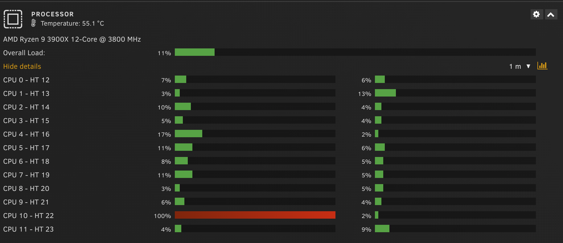

Completely reinstalled Windows 11, exact same performance issues and weirdness with a single thread used at 100% and Windows performance graphs halting while a transfer is running. Yes I am using the Rust version. I will wait until other people with AMD CPUs test this out. I am completely out of ideas.

Maybe try emulating your CPU instead of CPU passthrough and a test to see if speeds improve. Not saying you should leave it that way but it may be worth trying to see if it's an AMD issue.
Thanks for the suggestion. Same issue though, ~40-60 MiB/s and a single cpu thread gets pegged to 100%. With emulated CPUs however the performance graph in Windows doesn't lock up. I think we just need more people trying this out with different hardware configurations. So far everyone I have asked uses Intel CPUs and it seems to work as expected.
