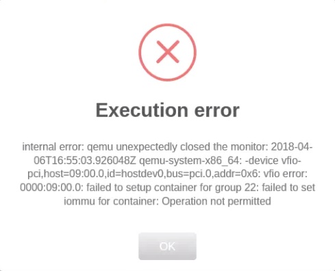

  10. Dear 1812, Thank you for your efforts. Your info has shed much info upon my situation that actually accidentally fixed my issue in a roundabout manner. The audio card issue has not been resolved, but a workaround was created in these efforts. In my thwarted attempt to backdate the BIOS, I instead decided to update to a more recent version in an effort of not being able to do one, why not try the other. Sure unRAID doesn't see a USB audio as a valid sound card, but now I can flag USB audio device and now it works through the remote desktop, which is just as good for me. This didn't work before my BIOS update and the allowance of unsafe interrupts, but now it does. The system before would see the USB audio device, but wouldn't play through the remote desktop for reasons beyond my knowing. Now I can free up that slot for a USB 3.1 card and improve the dynamics of this box. As a FYI, to restore the systems BIOS back to prior 2011 BIOS, you either have to have the original ROMpaq CD/DVD that came with the system (or have access to one) or have an active service agreement open with HP. I'm not putting this box in another service agreement. Especially not with the flexibility that unRAID gives me. This box dies, remove unRAID USB, all drives, and hello new equipment. So the issue has not been resolve, but has. I recommend to anybody having audio issues, disable the sound card and use an USB audio device. It's not the fix we'd like to see, but it's cheap and works. So update BIOS, update unRAID, allow unsafe interrupts, plug in a $10 USB audio device, and select that device as a USB device in a VM. Does one device work with multiple VM's? No, but if needed, purchase multiple USB audio devices by different builders. It's still a cheap fix and also keeps your system security up-to-date. Thank you 1812. Maybe that helps someone else?
  11. Changed the syslinux 100% as requested. The audio card is in an iommo group (22) of it's own now. I'm still getting the same error thought, aside from the date part of the code. Attached is the immediate after diag file. For some reason I thought I remember seeing the audio card have two occurrences in the System Devices and now there's only one. I'm doing this remotely and thankfully it hasn't locked up yet. Not sure what I did the one time, but that wasn't fun. I'll be on-site tomorrow (Tuesday, EST 9am-5pm) if there's any BIOS info needed. Again I really appreciate the help. I've looked at the diag files myself, but I'm not experienced enough to know what all I'm looking for. If there's somewhere I can do some reading on better understanding the subject other then searches, I'd feel more useful. Currently I'm just 13th Warrior'ing this thing till it starts becoming common sense. Thank you diagnostics-20180416-2130.zip
  12. Syslinux... default menu.c32 menu title Lime Technology, Inc. prompt 0 timeout 50 label unRAID OS Test Settings menu default kernel /bzimage append vfio_iommu_type1.allow_unsafe_interrupts=1 initrd=/bzroot label unRAID OS kernel /bzimage append initrd=/bzroot label unRAID OS GUI Mode kernel /bzimage append initrd=/bzroot,/bzroot-gui label unRAID OS Safe Mode (no plugins, no GUI) kernel /bzimage append initrd=/bzroot unraidsafemode label unRAID OS GUI Safe Mode (no plugins) kernel /bzimage append initrd=/bzroot,/bzroot-gui unraidsafemode label Memtest86+ kernel /memtest diagnostics-20180406-1252.zip
  13. Sorry for my delay is response to this. I had to prioritize some other things over this project last week. So I added the line above to allow unsafe interrupts, reselected the audio config for the Win10 system and I'm getting the same exact error above still. I went into the BIOS and tried to manually reassign the audio card to another IRQ and memory address, but the system keeps moving the devices on the same interrupts along with it, like the RAID controller. I read earlier that the RAID controller doesn't play well and am I possible a victim of circumstances here? I have 6 disks in this system running off the RAID controller, but not using the hardware RAID. So using the onboard SATA won't work with only 2 ports. I also have an PCIe external SATA for an external array, but the array isn't plugged in at the moment and it's just a PNP, no BIOS card. I'm just tossing out some thoughts. I'm going to be trying to get this box working 100% by the end of week So I can start the next leg of projects related to this system. If I need to order another audio card, I'm open to suggestions. Thank you and everybody in advance for any help!
  14. The attached image is what I'm seeing when I launch the Windows 10 system with the Sound Card option enabled for this VM. I tried a few different BIOS options in unRAID, but didn't see to have any further luck. Some time back I saw someone talk about making a change to the system config file and I tried adding a line (I forget what line exactly now) to unlock a feature, but this resulted in preventing the system from booting in general. I know that little info doesn't help, but I'm a one man IT team doing lots of work and I'm not always quick to make notes on negative results just in case I might have did something wrong. I like to leave my doors open to re-explore failed attempts. There's way more to be learned from failures then successes. diagnostics-20180406-1252.zip
