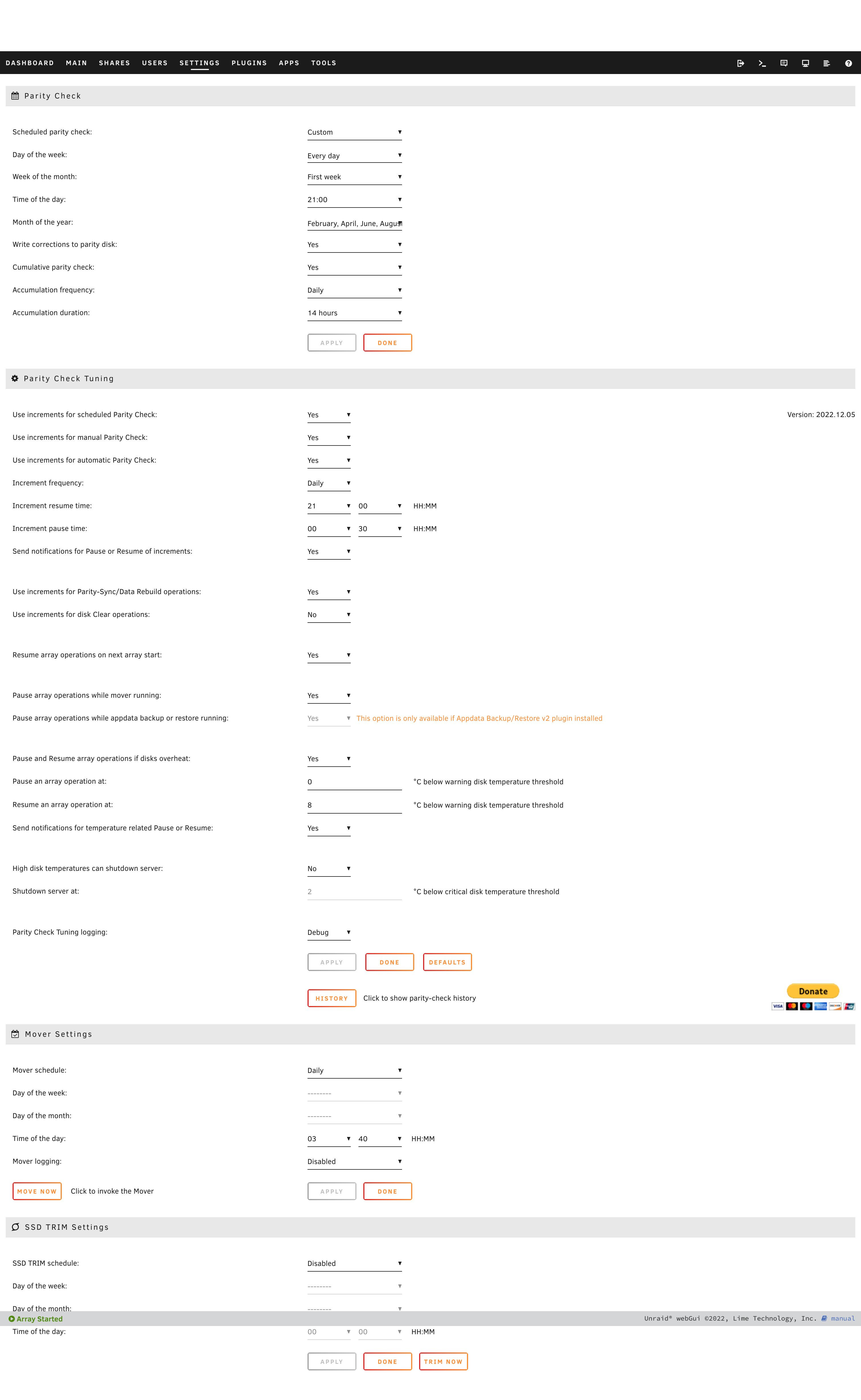

  8. Can someone tell me what I am doing wrong? I would like parity check to run once every 2 months - start at 11:30PM each night and run for 12 hours till about 11:30am - then repeat until the whole process is finished. I have attached what all my settings are. Right now parity seems to start around 10pm and stops every night at 12:30am. I have 18TB drives - so at this pace - it will probably take 3 months to finish a parity check. Anyone have any ideas?
