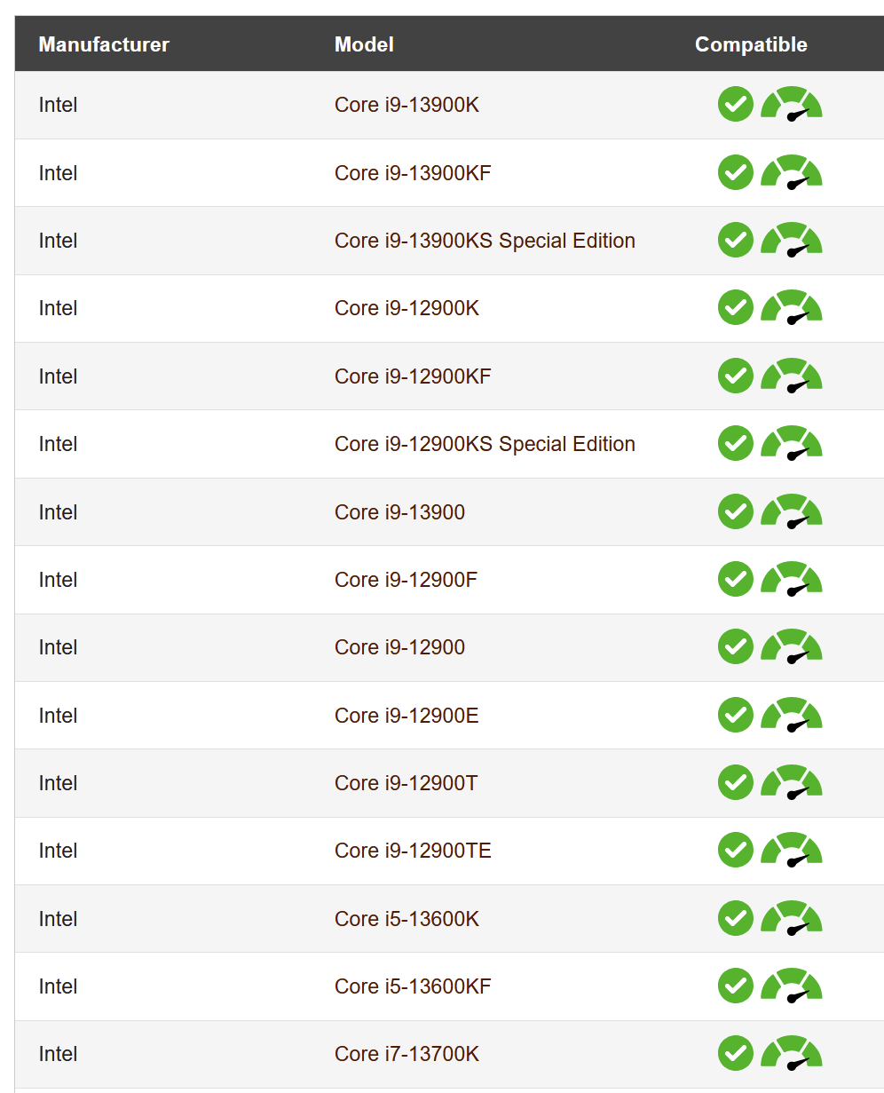

motherboard with enough SATA connections that I would only need 1 additional LSI expander.
I like the Supermicro X13SAE-F
  • 8 SATA ports
  • IPMI
  • 2.5 GbE
  • 3 M.2 NVMe slots
  • ATX
Here is very well-priced combo that includes, MB, I9-13900K CPU, 4U case compatible heatsink, 64GB RAM, 1TB NVMe SSD.  I (and many others in these forums) have purchased combos from this seller. Very good and reliable.
If you really want/need 10 gig networking, check out the ASRock W680D4U-2L2T/G5 available here.  Also here is the dual 1 GbE NIC version which is impossible to find right now.

I think the thing that scared me the most was the Supermicro mobo potentially not supporting the CPU out-of-the-box without a bios update. I also wanted 10GB on the mobo.
Edited by Riverhawk
