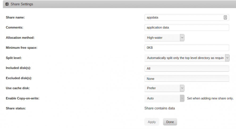

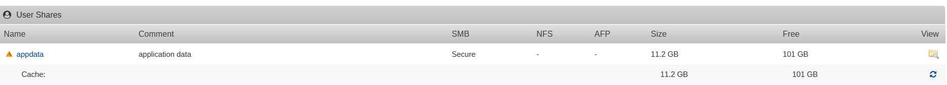

  8. Apologies, Still learning as I go I have attached a picture of the "appdata" share config. When changing from "mnt/user/appdata/plex" to "mnt/cache/appdata/plex," it causes plex to crash, I have uploaded the logs from that also PMS Docker Log.txt
  9. would this now be correct? root@localhost:# /usr/local/emhttp/plugins/dynamix.docker.manager/scripts/docker run -d --name='plex' --net='host' --privileged=true -e TZ="Australia/Sydney" -e HOST_OS="unRAID" -e 'PUID'='99' -e 'PGID'='100' -e 'VERSION'='latest' -v '/mnt/user/TV/':'/tv':'rw' -v '/mnt/user/Movies/':'/movies':'rw' -v '/mnt/cache/appdata/plex/':'/config':'rw' 'linuxserver/plex' 43417fdca655f58dd62c261e8951e43bbe70c4a23f8dbb80f47372658c9834a2 The command finished successfully! ok changing it to that just results in PMS crashing
