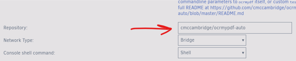

  7. Hi @Toskache, @nik82, @sunpower, Apologies for being absent this past week, and thanks for your patience! Thank you for letting me know about this issue. From your description and screenshots, I believe I understand the problem, and have deployed a fix to resolve the "Not Available" message under the Version column on the Docker tab. However, since the bug is related to checking for and applying updates... we may need to be a little more hands-on to repair your individual Docker containers. Details of the bug at the bottom, but first, let's get your Docker containers fixed.... this process will be one-time only to get past this update-related issue. From your Docker tab, find the ocrmypdf-auto docker container that you have configured. It will be shown as in @nik82's screenshot, with the "Not Available" status in the Version column. Click on your ocrmypdf-auto docker container and select Edit From the editor, find the field named Repository and edit the value to be exactly: cmccambridge/ocrmypdf-auto Please note that you will likely be deleting the text "quay.io/" from the beginning of this field. At the bottom of the page, click Apply. Unraid will restart your container and update it to point to the Docker Hub repository instead of quay.io. This will also update the image if your local container was not previously up to date. After returning to the main Unraid Docker tab, click the "Check for Updates" button at the bottom of the page. This process will take a few moments. You should now see proper version information for ocrmypdf-auto: That's it! Let me know if you continue to experience any issues. More technical details, for the curious: The container itself was not experiencing any problems. You should have noticed that it was still shown as ▶️started and was operating correctly. The trouble lies in Unraid's docker manager page, which is designed for the standard/first-party container repository Docker Hub. Although Unraid's docker manager does support installing and running a container from a third-party container repository like quay.io, it does not properly handle version and update checks for such a third-party repository. I learned about this rather too late, and had already deployed a few Community Applications using quay.io 🤦‍♂️ ocrmypdf-auto has not had any feature changes since I learned of the version reporting issue, so I had never gone through the migration process to Docker Hub, and Unraid's docker page simply reported "Update available" in many cases when no update was actually needed. For better or worse, the latest Unraid version is improved to be aware of the failure to query version information from third party repositories, and shows this failure as the "Not Available" message we've all been seeing on ocrmypdf-auto lately. The Fix: I've migrated the ocrmypdf-auto repository from quay.io to be mirrored at Docker Hub I've updated my Community App template for ocrmypdf-auto to refer to the Docker Hub version of the container, so all future users will never experience this issue. I've documented the manual remediation steps for you all, as I'm not confident that the update to the Community App template will necessarily be automatically applied for you, given that the bug is related to checking for updates, and I don't want anyone stuck with a broken container! Thanks again for reporting this issue, - @cmccambridge

  9. Ugh, great catch. Thanks for letting me know @JasonJoel! This bug has been there since I migrated from quay.io in April 2019 and I never noticed, because I made the same edit locally that you've just done... Good news is your fix is exactly correct. I've committed the same to the template repository, so other new installs and folks accidentally pinned at 1.5.8 should receive the update soon as well. Fixed with this PR.
