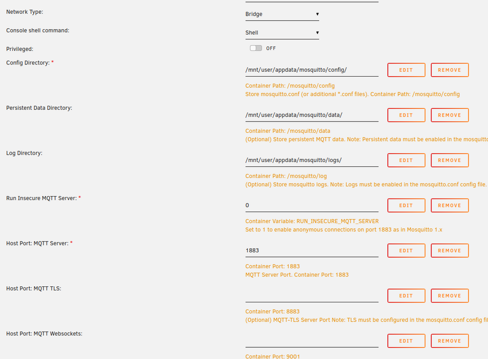

sorry if my question is stupid but am trying to install the container and can't follow the steps.
i would like to run it with option 2 since 1 seems the least secure and 3 is not for me since i'm fairly new with unraid docker etc.
My Problem with option 2 is that the container i followed the steps and edit my mosquitto-unraid-default.conf file in the lines 28-30 and deleted the # so it looks like this:
listener 1883
protocol mqtt
password_file /mosquitto/config/passwd
now i start the container and it stops again. The logs show:
1726144166: Loading config file /mosquitto/config/mosquitto-unraid-default.conf
1726144166: mosquitto version 2.0.18 starting
1726144166: Config loaded from /mosquitto-unraid/include_dir.conf.
1726144166: Error: Unable to open pwfile "/mosquitto/config/passwd".
1726144166: Error opening password file "/mosquitto/config/passwd".
!! ATTENTION: MANUAL CONFIGURATION IS REQUIRED !!
Due to security hardening in Mosquitto 2.0, you MUST TAKE MANUAL ACTION to
reenable MQTT in this container!
OPTION 1: Set RUN_INSECURE_MQTT_SERVER to 1 in this container's settings
OPTION 2: Edit the file "mosquitto-unraid-default.conf" in your configuration
path for more details (Usually /mnt/user/appdata/mosquitto)
OPTION 3: Update your customized Mosquitto configuration to configure at
least one listener. See https://mosquitto.org/documentation/migrating-to-2-0/
https://github.com/cmccambridge/mosquitto-unraid#authentication
tells me to run (i assume in the unraid console since the container wont even start)
docker exec -it mosquitto touch /mosquitto/config/passwd
but the console shows me
Error response from daemon: Container b5dfb6360ea02ebf58e744cc1c166ff04e2e0496f46bb4cb778e0c2a4506698f is not running
if i do. which makes sense since the container is not running but it autostops every time i tell it to start.
any ideas whats wrong? i did not change anything else. screenshot of the containersetup is attached.
Edited by Icarium

Hello Icarium,
I just have the same issue as you and it is related to location, permission and owner of password file generated.
Here what I have done to correct :
  1. Launch this docker with anonymous permission (Run Insecure MQTT Server = 0)
  2. Create a new password file from docker console with command : mosquitto_passwd -c passwd MQTT_User
  3. Copy this passwd file to your persistent data directory : cp passwd /mosquitto/data/
  4. Stop the docker
  5. Go in your Unraid file manager and set permission Read-only to "Other" at least on this file
  6. Change in your docker settings Run Insecure MQTT Server to 2
  7. Edit config file mosquitto-unraid-default.conf  and uncomment the following last line:
    1. listener 1883
    2. protocol mqtt
    3. password_file /mosquitto/data/passwd (change with the location of you password file from your persistent directory)
  8. Start your docker and go in your docker console to change permission and owner of your password file with :
    1. chown mosquitto: mosquitto/data/passwd
    2. chmod 700 mosquitto/data/passwd
    3. Check with : ls -l mosquitto/data/passwd
Hope it helps you and other people to save some time in search not like me.
