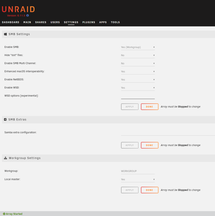

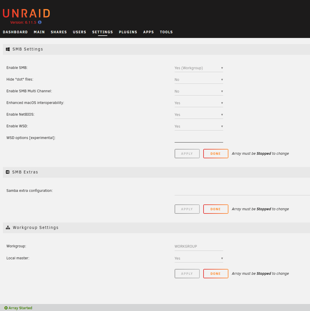

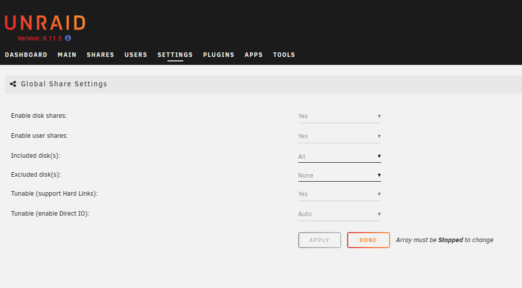

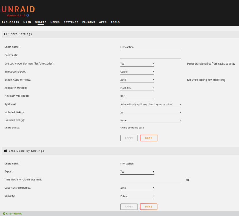

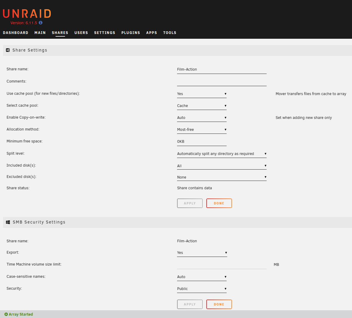

  6. I should say at the outset that I've already tried this fix, but it didn't fix my issue: All of my 5 unRAID servers are set up the same - just sharing video ISO files - no VMs or Dockers. All are running v6.11.5. All running on HP Proliant Microservers (N36L, N40L etc.) with 8GB RAM installed. I can see all servers listed in Windows (10) Explorer. Windows 10 has SMBv1 enabled. For three of them (UNRAID-02, UNRAID-03, UNRAID-04), I can click on that server and see and access all the shares - e.g: \\UNRAID-02 On the two problematic servers (UNRAID-01, UNRAID-05) - when I click on the server name in Windows Explorer, after some delay I get the following error message, and clicking [Diagnose] reveals no identification of the problem. These are some relevant settings I have on one of the problematic servers. As far as I can see, these settings are all the same as on the other machines whose shares work as expected. All shares have SMB security set to 'Public'. Any suggestions what might be wrong? Example share:
