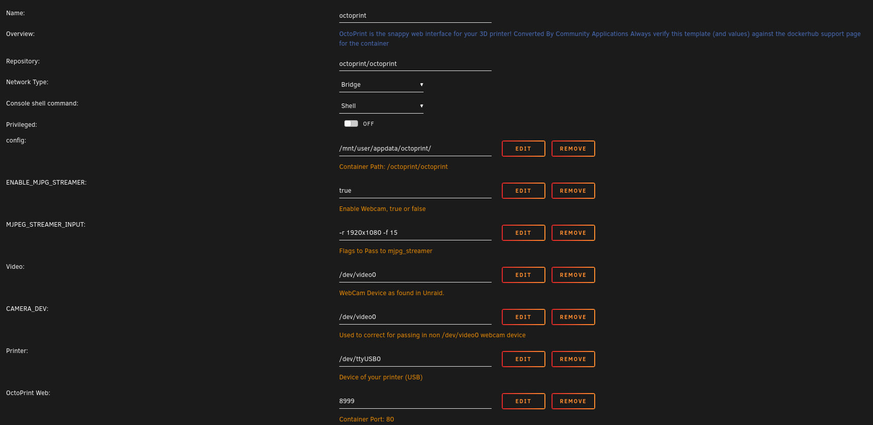

  3. Hey printer friends, I have another update. Took on the upgrade octoprint task while maintaining webcam. It was rather easy. I deleted the nunofgs docker for octoprint. I searched community apps for octoprint, selected the docker hub images, found the octoprint/octoprint official docker image. I installed it and configured the template you see in the image attached. I have not figured out how to submit a template to community apps, so for now this should do. I'm not sure 100% if anything might be missing or need a tweak. Let me know how you make out. Note: i did use pretty much all the same values as before. I used the same config folder as the old one. It accepted the configs and everything came right up and all I had to do was create an account. Plugins were all blown away. So you will have to reload all those.

  12. If you can get the snapshot you should be able to get the stream also. I was talking to someone about similar issues and they said using the port i used in my container fixed the problem for them. I don't know why that would be the case but it was what they said worked. I used 8999. You should be able to access the stream directly using this URL (replace your unraid server IP and port number.) http://192.168.2.1:8999/webcam/?action=stream Also, you can strip off the ?action stuff at the end and you should get right to the webcam webserver and see both the stream and snapshot functions. I also changed the stream settings inside octoprint also. In settings under webcam & timelapse, i changed the Snapshot URL to: http://127.0.0.1/webcam/?action=snapshot and the Stream URL to http://192.168.2.1:8999/webcam/?action=stream (obviously using my own unraid IP and port.
  13. I was able to resolve this finally. the issue was drivers as i suspected. Video 4 Linux was needed. I was able to find this driver set in the LinuxServer.IO plugin for DVB. i used the LibreElec release on the latest 6.8.2 kernel they offer. I am now .1 version behind but i am able to do what i need to do with the webcam. after installing that plugin and downloading the LibreElect 6.8.2 release i rebooted. I then have 2 /dev/video0 and dev/video1 devices. only /dev/video0 works. Passing this into the docker similar to above replacing the /dev/bus stuff with /dev/video0 was what i needed to get this going. Hope that this helps someone in the future.
