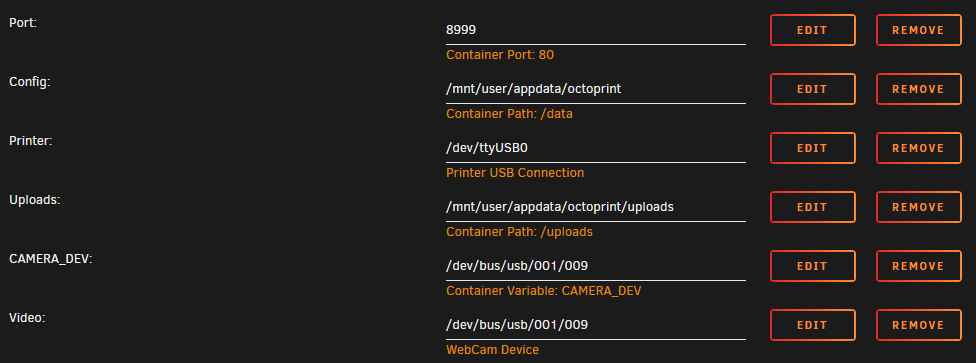

I an trying to pass a Logitech C920 webcam into docker for use with Octoprint. When i plug the camera in, the dmesg shows the usb device getting connected, gives it a number etc. It does not generate a /dev/<thing> entry on the file system however. lsusb lists it as a device and you can go into /dev/bus/usb/001/00x and see it but i don't think this device actually works. I passed this device into the docker container and set the env variable. i see the device show up in the docker container per my passed in device... and i see the log for the container say it tries to access the device for the camera but it says it cannot read the device and then fails to initialize the video. So at this point im not sure what i am missing. Is there a kernel module/drive missing somewhere? Is it a permissions issue? Other config issue? If anyone has any idea's i would appreciate it. Thank you!
Docker Container I'm using:
https://hub.docker.com/r/nunofgs/octoprint/
I did define the env variable for the camera device to point to the same as the device i define in the docker config also.

I was able to resolve this finally. the issue was drivers as i suspected. Video 4 Linux was needed. I was able to find this driver set in the LinuxServer.IO plugin for DVB. i used the LibreElec release on the latest 6.8.2 kernel they offer. I am now .1 version behind but i am able to do what i need to do with the webcam. after installing that plugin and downloading the LibreElect 6.8.2 release i rebooted. I then have 2 /dev/video0 and dev/video1 devices. only /dev/video0 works. Passing this into the docker similar to above replacing the /dev/bus stuff with /dev/video0 was what i needed to get this going. Hope that this helps someone in the future. :)

If you can get the snapshot you should be able to get the stream also. I was talking to someone about similar issues and they said using the port i used in my container fixed the problem for them. I don't know why that would be the case but it was what they said worked. I used 8999. You should be able to access the stream directly using this URL (replace your unraid server IP and port number.) http://192.168.2.1:8999/webcam/?action=stream Also, you can strip off the ?action stuff at the end and you should get right to the webcam webserver and see both the stream and snapshot functions. I also changed the stream settings inside octoprint also. In settings under webcam & timelapse, i changed the Snapshot URL to: http://127.0.0.1/webcam/?action=snapshot and the Stream URL to http://192.168.2.1:8999/webcam/?action=stream (obviously using my own unraid IP and port.

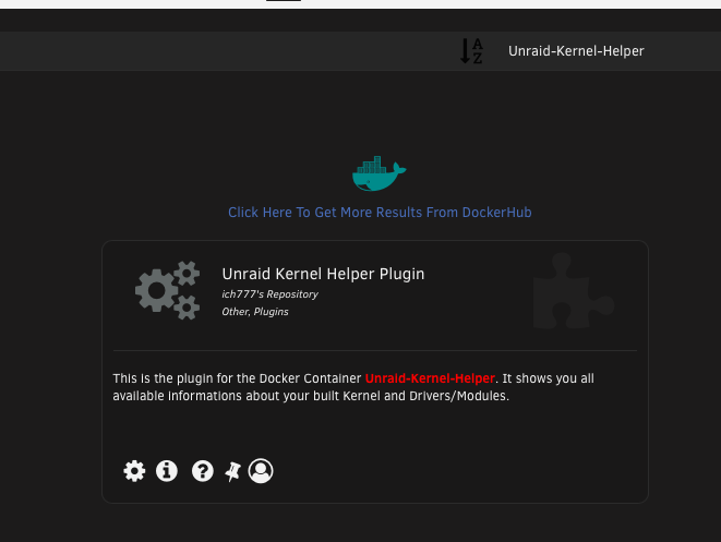

Hi, there is no more "Unraid Kernel Helper" or do I miss something? Is there a other way? thx
The Kernel Helper requires unRaid 6.9.0-rc2+ to run so it's not listed unless you're on that version.
Should be there for 6.8.3, otherwise there are prebuilt images for 6.8.3 on the support thread.
With all that said, I've been on 6.9.0-rc2 for weeks and it is pretty solid, installing the DVB drivers is as easy as installing a plugin
For those who may not know now that 6.9 is out the DVB stuff is a plugin and can be found by searching the APPs tab for "dvb drivers". There is also a section on the left for drivers that will filter down everything to just plugin based drivers.
I updated to 6.9 and installed this and restarted and everything just worked without issue. This is mentioned in previous comments here also but figured I would at least mention that it does work for the needs of octoprint and is pretty much a one click solution now.
