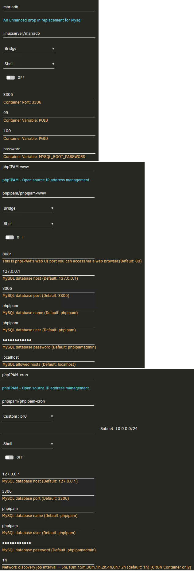

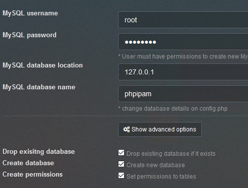

  6. My apologies for the delayed reply... got a little frustrated and left it alone. However, I really want this setup so I decided to come back to it. So I'm not sure if its MariaDB, phpIPAM-cron, or phpIPAM-www. Please note, I'm a bit new to MariaDB, I have spent some time getting familiar with MariaDB by creating DB's, Users, etc... Here are the following config for each one of the plug-in's. When I attempt to setup the PHP IPAM using the WWW GUI. The error I get each time when I use the Automatic database installation. Plus I'm fairly certain the localhost is listening on 3306... At this point, this is the brick wall I've hit. Any help with this is greatly appreciated ;)!
