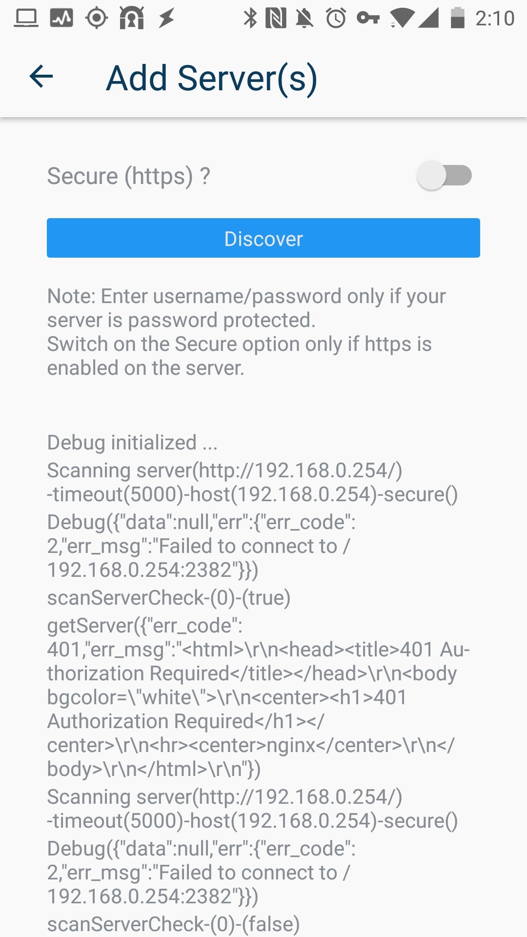

  1. Ok, my bad - turns out this is the error when you typo your password! Sorry guys. Was blinded by the port being different - although I was right, I WAS doing something dumb!
  2. This is with the port box saying 80, but to try and give an extra option this is the result of two attempts, one with port 80 which I would expect would work, and one with it set to 443 just to see if it alters the debug. Pretty weird, its as if the port box is being ignored. I'm guessing I'm doing something dumb here! No reverse proxy, no port redirection. No docker containers listening on that port either, and I can load the unraid UI on port 80 before and after running this debug.
  3. Hi, just bought the app and I'm struggling to add my server. I can access unraids webUI from my phone in its current environment. Just updated to 6.6.0, but this issue also affected the previous version. Adding the server using http manually, causes the following debug info (what I think are the relevant bits, if the full thing is needed I'll get you that later on). failed to connect to <unraid server ip>:2382 The server error information below this seems to be getting a http 401, with the body html returning mentioning nginx. From what I've read, thats the port the plugin listens on. I tried installing the plugin, and yet the situation is the same.
