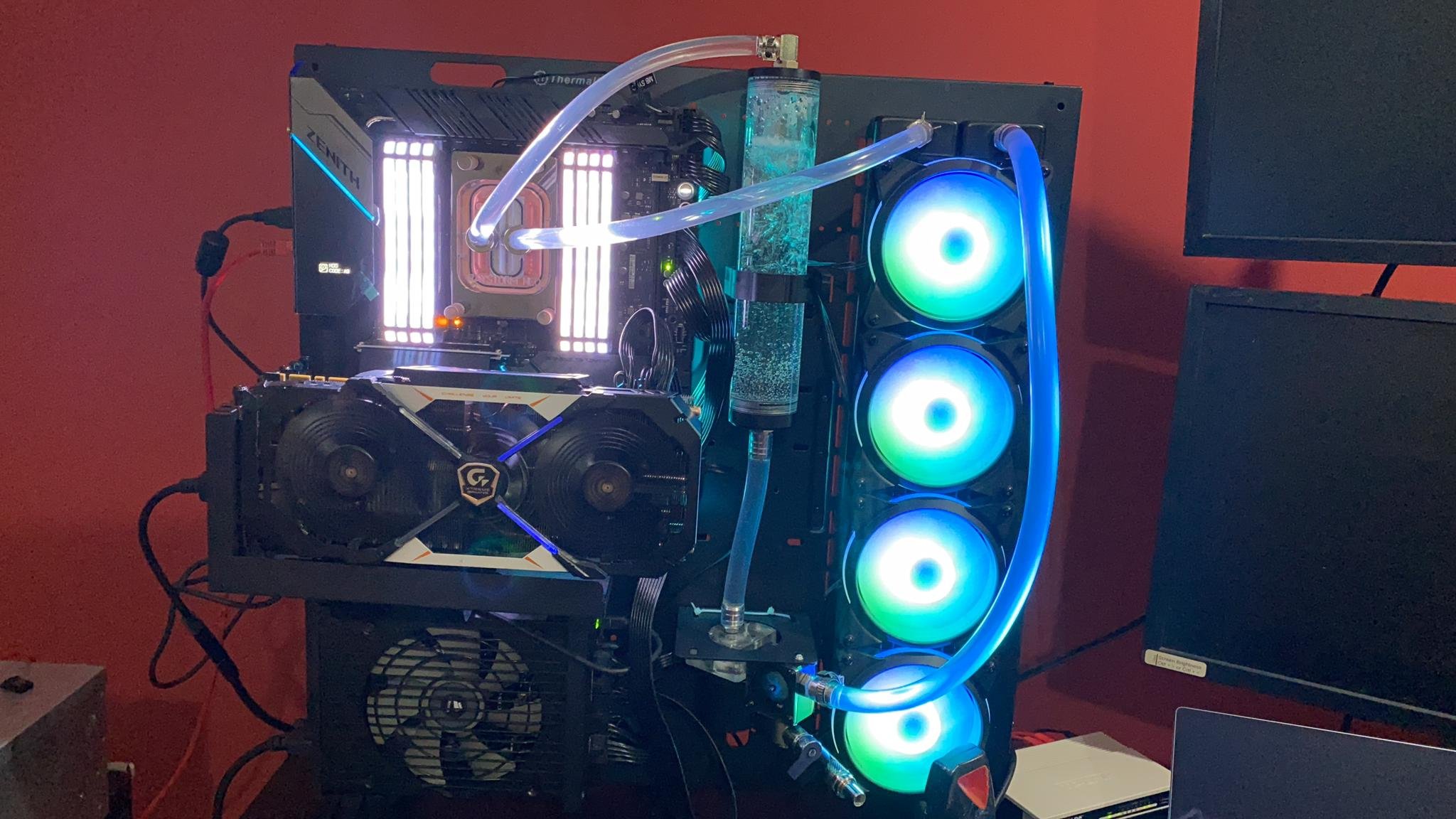

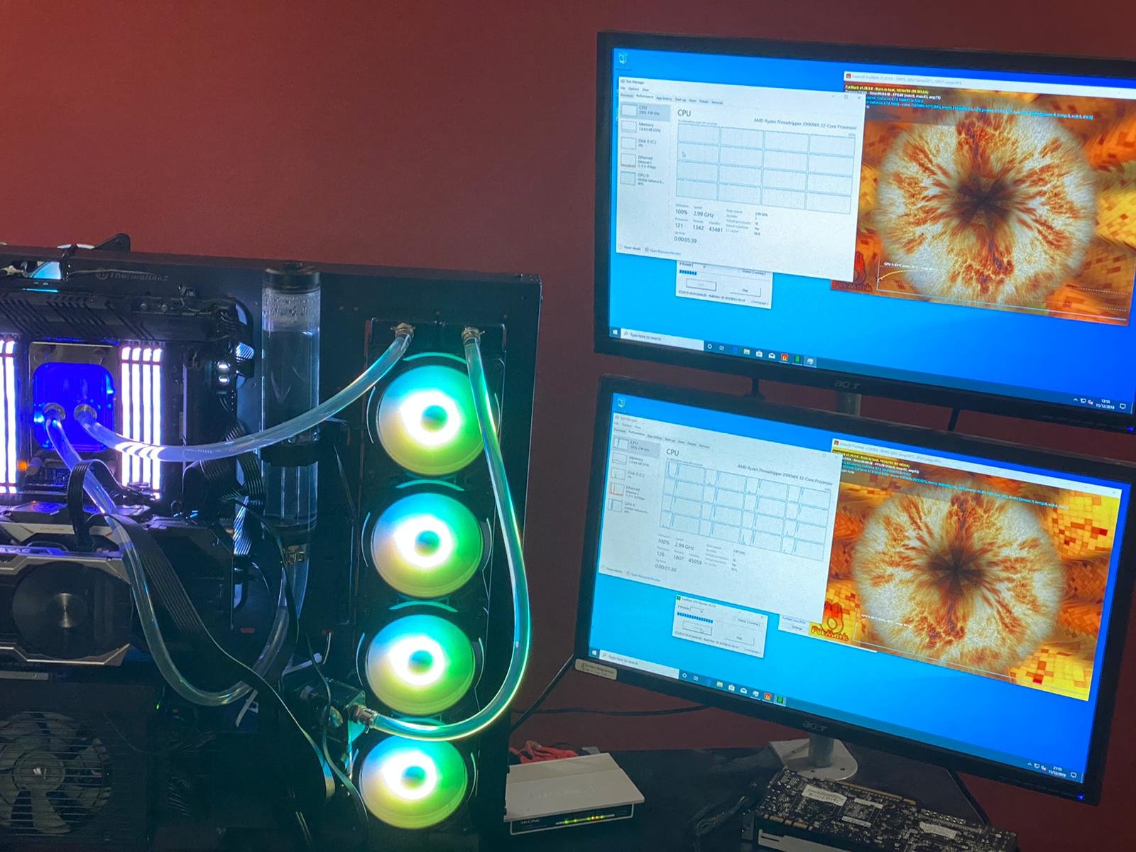

  1. Hello all, I just wanted to give an update Regarding where I am: VM 01 GTX 1080 with BIOS Dumpped Slot 1 8GB RAM 32 Cores Running Furmark and CPU at 100% VM 02 GTX 1060 Slot 2 8GB RAM 32 Cores Running Furmark and CPU at 100% Ran both systems for 12 hours, no issue at all. The above is just a test scenario. Obviously there's a lot more consideration needs to be done regarding the CPUs, and a variety of other things. Today I should receive another GTX1060 where I can test all three video cards at the same time. I have not done any tweaking as such, however John's recommendation of resetting the BIOS really helped when the VM's were fairly slow and sluggish. Without UNRAID, I have overclocked the CPU to 3.6 GHz on all cores stable. However after resetting the BIOS to optimal defaults, and changing the CPU ratio from auto to 36. All the VMs become sluggish again. I am not sure why this is the case. Any Insights are more than welcomed. Next steps: Figure out the USB configuration, which USB controllers should be passed through. Maybe use of a HUB Tester video capture card, and see if it is viable Pin down the appropriate cause to the appropriate VM's benchmark systems accordingly and compare VM to bare metal performance Thank you all for your support. It is really appreciated!

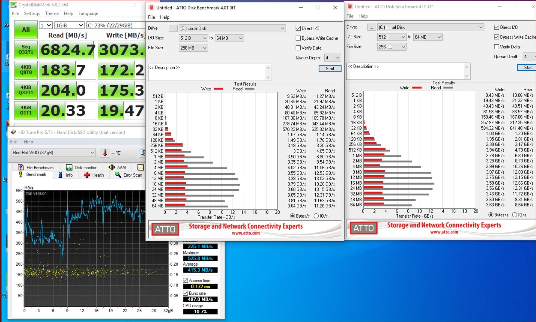

  8. Hello John, I should give you an update what's happened with my install. Unfortunately I had some water damage so I had to go through the insurance company and buy a new motherboard and memory. I have a few questions for you if I may: What version by us are you running. I have installed the latest one. Version 2001 when installing a VM, it is installing incredibly slow. What are your settings regarding the BIOS and any other special settings. Please note I am using only a SSD at the moment. And I would like to get it working first before I try using the MVMe I am not using a second video card just yet. But when installing Windows 10 it is incredibly slow, so I'm not quite sure what I'm doing wrong. Thank you very much.

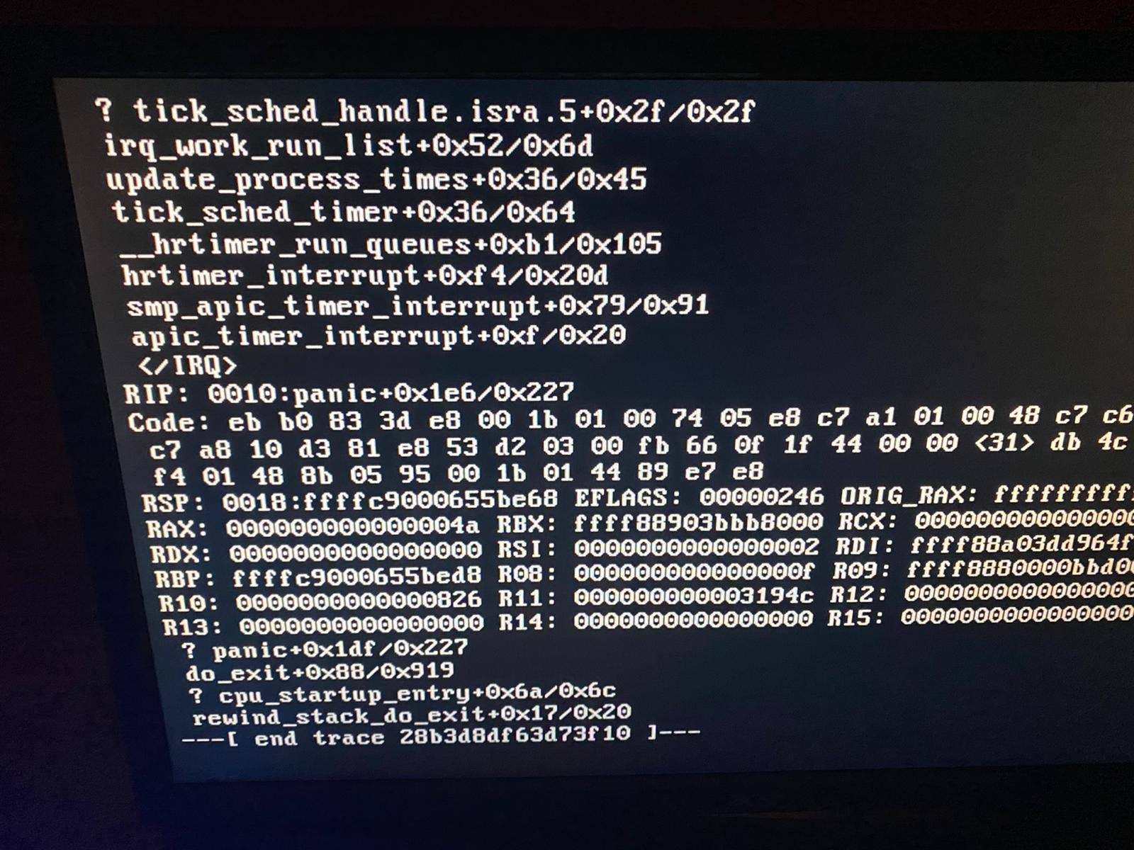

  9. Hello all, The ROG ZA has 2 NICs. 1. 1GBit 2. 10Gbit If I use the 1 Gb Everything starts perfectly and I am assigned an IP address. The moment I plug in a cable to the 10 Gb LAN port. The system panics. I am not sure what is going on, I have the latest version of UNRAID And the latest BIOS. Thank you very much
  10. I switched the cards and now it is working. It does not like the 650 TI boost... I will keep you all updated. Thank you
