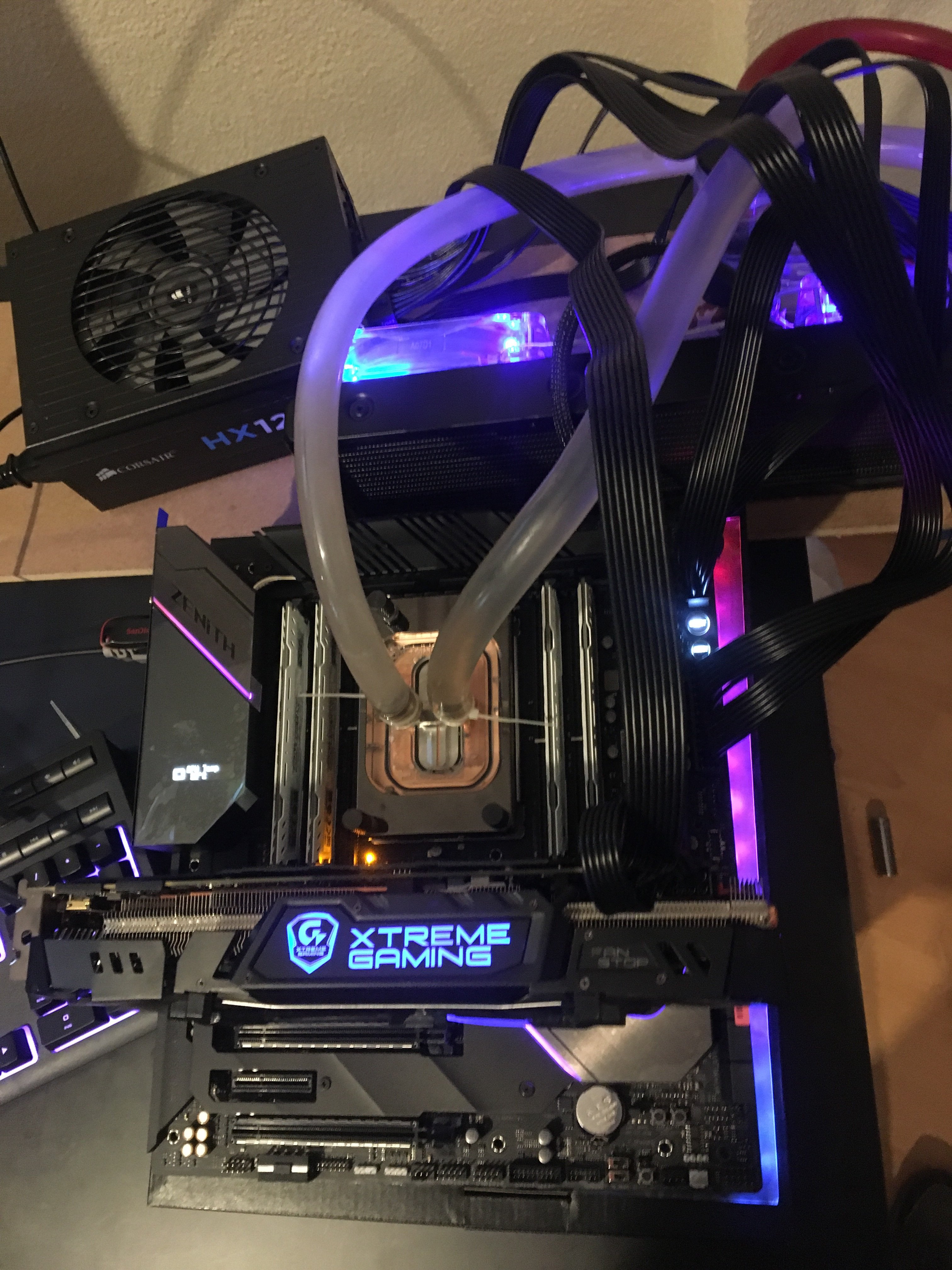

Hello all, This post is about how to configure the ASUS ROG Zenith Extreme Alpha X399 + 2990WX. Now of course this is ONE HUGE learning curve fro me. However, there are something I have picked up along the way and some problems. Key facts (Good News) I have the ASUS ROG Zenith Extreme Alpha X399 + 2990WX working with unraid on it. I have dumped the BIOS for an EVGA GTX 1080 and it is passed through to a VM on PICE 1 I am presently ONLY using 3 SSD drives I have ran Intel Burn Test and FurMark, 62 cores at 100% load for over 24 hours. No problem at all. Key Fact (Bad News) I have tried adding a GTX 650TI, GTX 680 OC, 7600GT and pass them through to a VM on all PCI port except. Nothing. I cannot get it working Questions When I setup the UBS with UNRAID, I used UEFI mode. Could this effect the UNRAID / GPU Pass through? Objectives To make this post a good guide for those who are in the same boat as me To have 2 or 3 VM with their own GPUs Guide I am making that now.

Hello all, First successful boot. Everything seems to be working. Just testing it with Windows 10.. Will keep you fully updated cannot wait to get unraid on it
