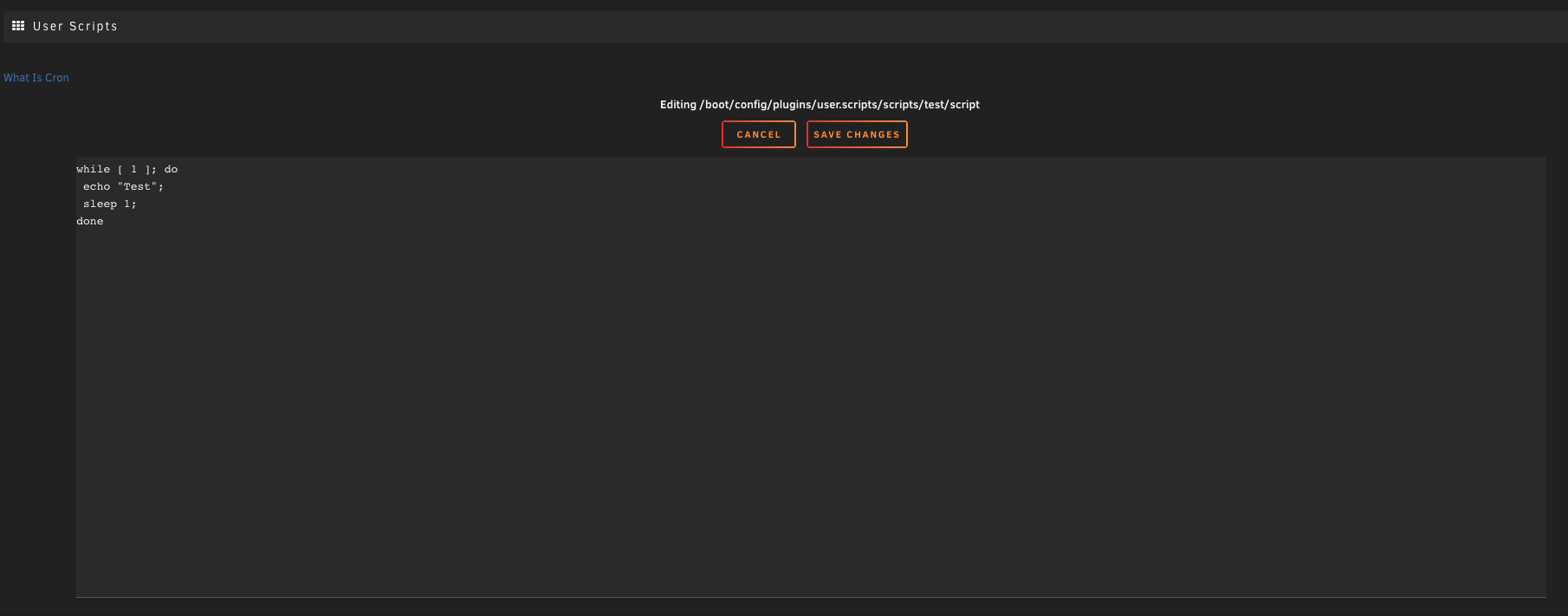

  10. @Squid My issue still persists. Here is a test script: After aborting it, the script process is still running: What am I doing wrong?! This is how it gets spawned if I press background process: The process 10197 survives if I press abort. Plugin is up-to-date and running on unraid 6.9.2.

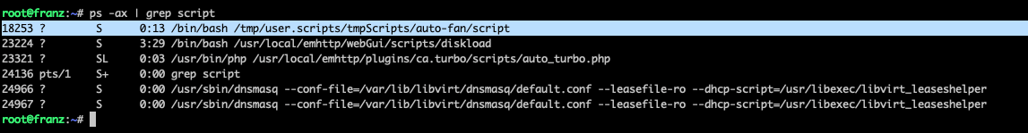

  11. But it doesn't spawn any new process. The content of fan-script.sh is the content of the user script.
