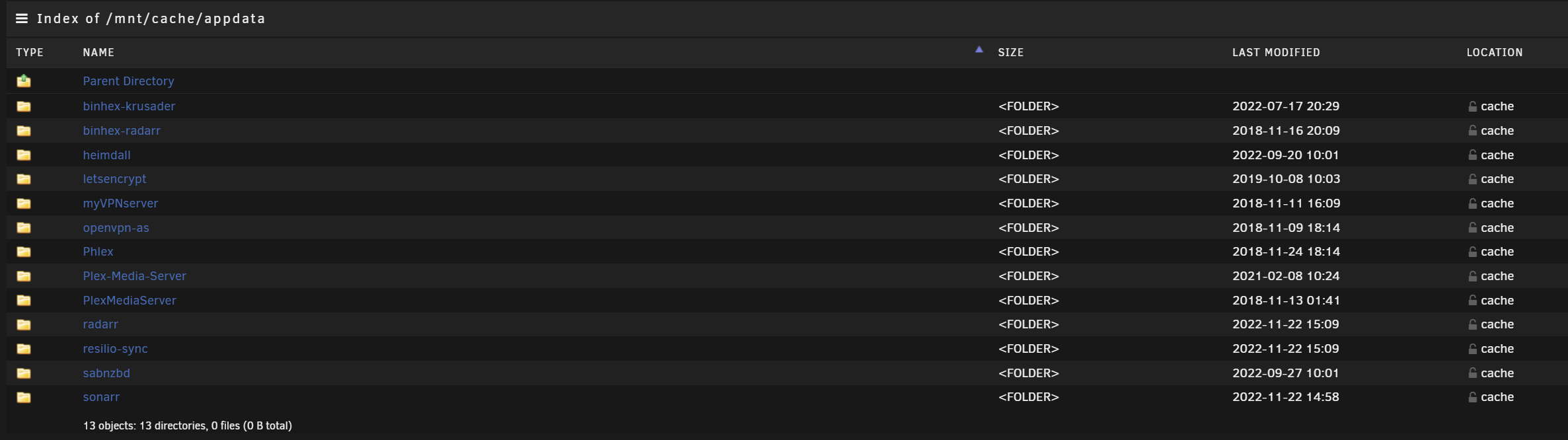

  3. 1) I set appdata, backups, system, and Transcode to "Prefer:Cache" 2) I am running mover 3) when mover finishes, the appdata folder should be full of the app data from disk3. So at that point, I just go to "Apps"->"Previous Apps"->"Select All on Page"->"install 13 selected applications." (I don't need to run Restore Appdata because the appdata that mover moves over is already the most current appdata, I didn't lose the app data and have to recreate it from the backup tar.gz.) Then after I install the 13 selected applications, just reboot the server and I should see all the apps in the Docker tab, yes?

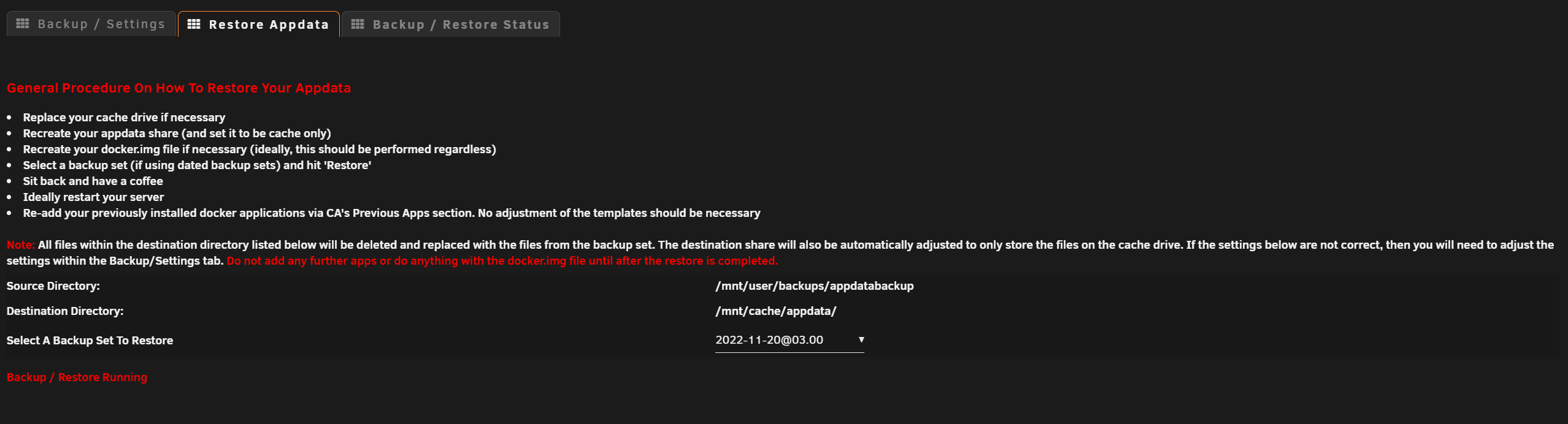

  4. Okay, I'm paddling back to shore. I got the Cache Drives functioning. Mover is moving the contents back to the cache drives. When mover is complete, do I need to recreate the docker image, run CA restore v2, or copy the appdatabackup folder or some combo?

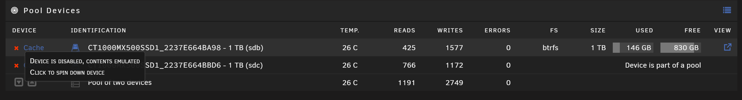

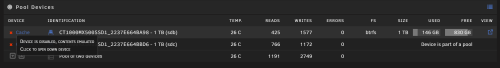

  5. How do I get the cache drives not disabled?

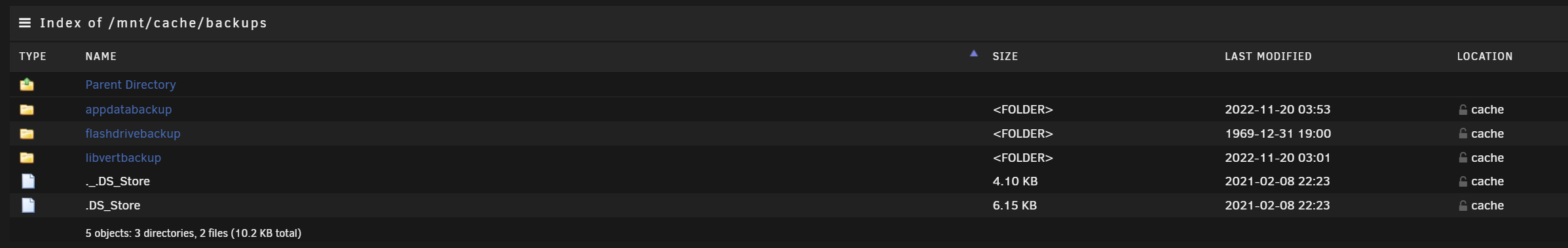

  6. okay, so i ran the restore feature, but it didn't work, now I see this: Docker still shows this What should I try next?
  7. I have the appdata and appdata backups, but how do i restore them?

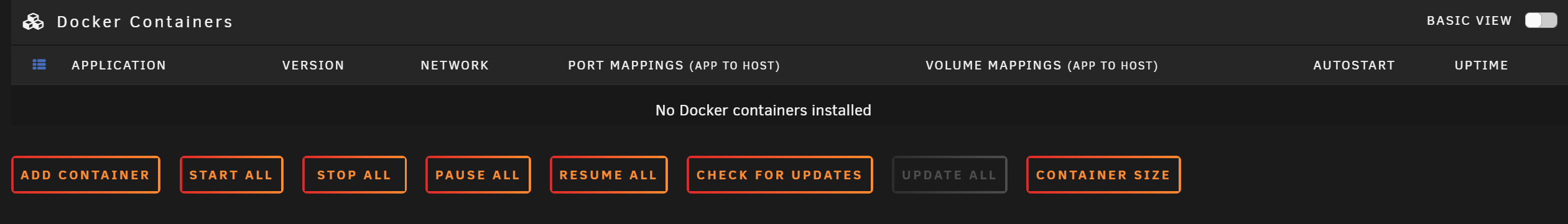

  8. Hi, i'm running UNRAID 6.11.5. I had 2 250 GB SSDs in my Cache pool and they were consistently filling up. So I followed this procedure: I replaced the drives with 2 1TB SSDs, formatted them, adjusted the shares to use the cache, then ran mover. When I went to turn the docker containers back on, they were gone, and I realize I made a fatal mistake. I missed step 3 in the initial protocol: "Settings -> Docker: disable Docker and click apply" What should I do to undo the damage I've done, rebuilding every docker container from scratch would be very painful. I have the two 250 GB cache drives sitting next to the machine right now. I could reinstall them, but I would like advice before I make matters any worse.
