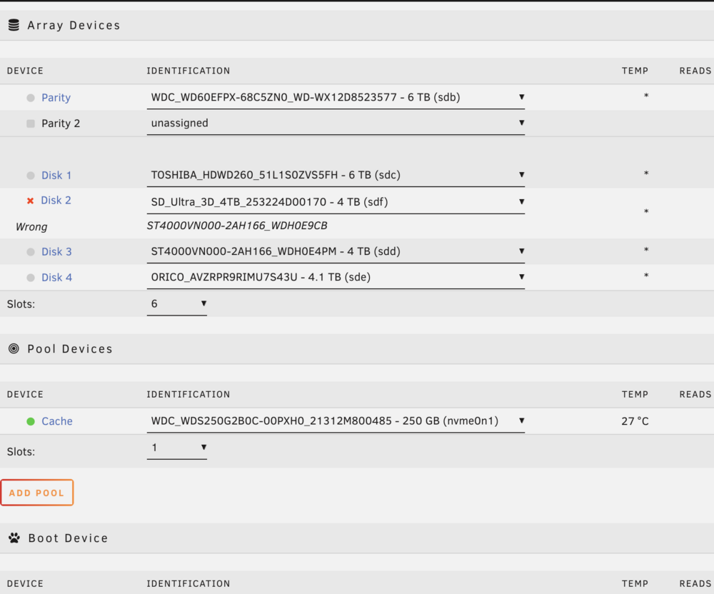

  1. Thanks for the help all. I ended u useing "New Config" with my old drives. The new SSD's crashed during calculating from parity to a new drive. So I had two broken SSD's. I popped in the original HDD's in teh correct order and did the new config. Its doin parity calc a swe speak. So I am never going to use SSD's and don't recomend anyone doing it. I kept my head clear and did not panic and kept te original drives, so crisis averted.
  2. I am going to make a drive copy. If the data is the same on the drive will the settings for Untaid like Docker images and VMs also stay working after this? Also thanks for helping.
  3. Dear support, I have a problem with a replacing of a HDD to a SSD. My Unraid system tels me that the drives are not the same size. But when I check on the system via terminal. root@void-unraid:~# blockdev --getsize64 /dev/sdf 4000787030016 They are the same. ChatGPT tels me to use "New Config" to populate the array for "New". But the text in "New Config" is so vage that I don't dare using it. See the screenshot for my disk config. Can someone explain the "New Config" stuff?

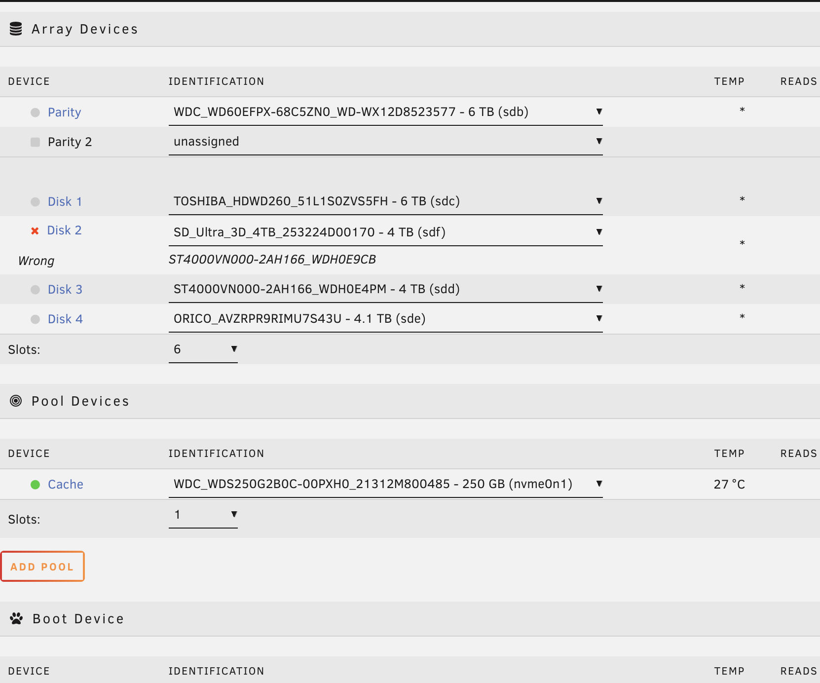

  9. I don't understand why the second image is there. The rebuild after placing in a new drive and with the blue icon I end up with the above images. Disk1 was broken and replaced. It also has been written to a lot in the past 18 hours. Please advise.
