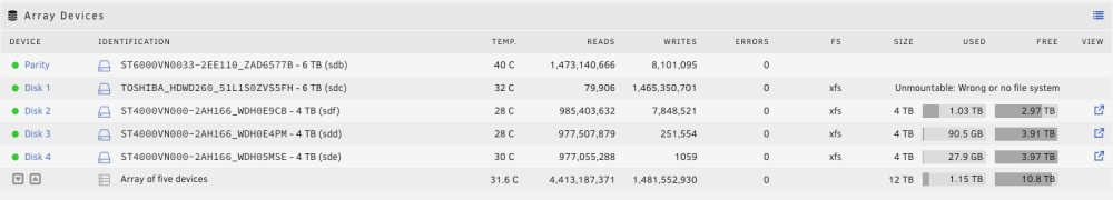

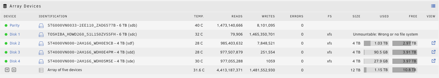

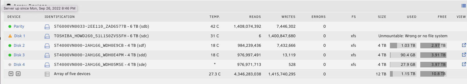

I don't understand why the second image is there. The rebuild after placing in a new drive and with the blue icon I end up with the above images.
Disk1 was broken and replaced. It also has been written to a lot in the past 18 hours. Please advise.

A rebuilt disk will show exactly hat was on the emulated one, please post the diagnostics.

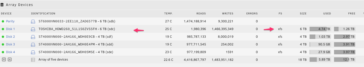

Does not seem to change anything.
Start the array in normal mode.
That worked! Wow, is this normal? My stress level was up there. Thanks for the quick response/support. I did lose some faith in the software.
