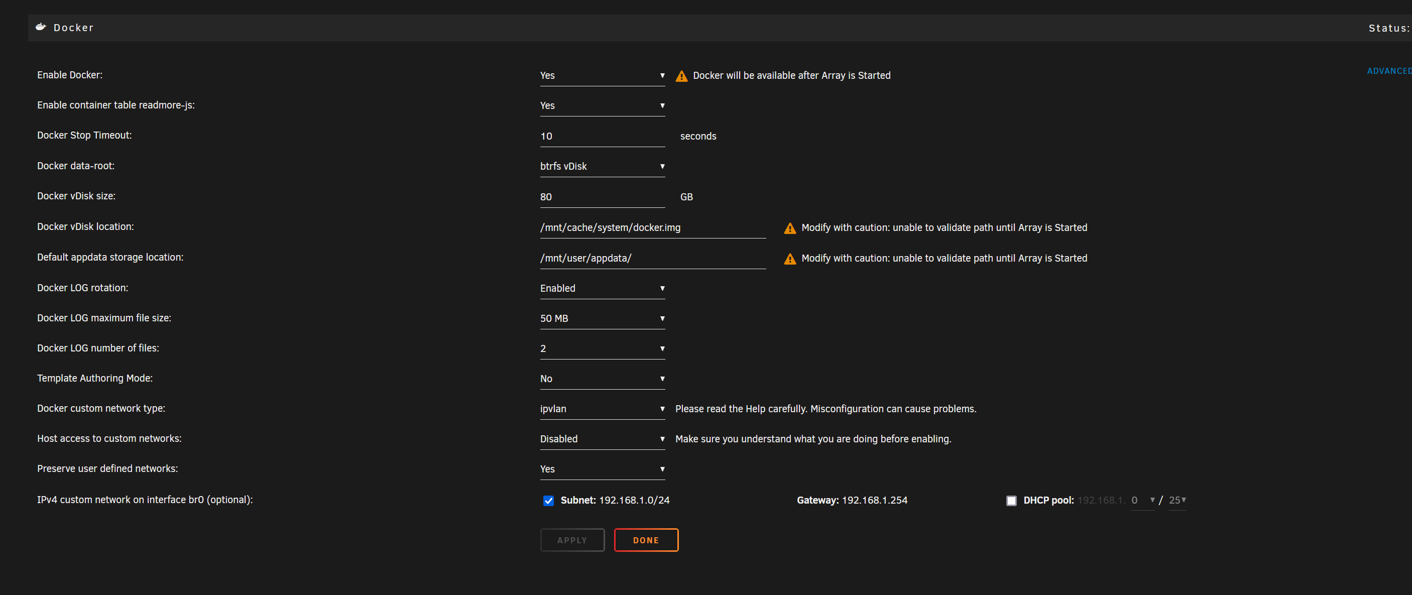

Hello again, Just providing an update. I have replaced the motherboard but kept the same CPU and ram. I did run the ram for 72 hours on memtest 86 with no errors. After replacing the motherboard, the system appears to continue to have the same problem. I am hesitant to replace my CPU, I am using the latest unraid as well. My current next steps are to "reinstall" unraid and see if it resolves the issue. One note I would also like to discuss is that my docker image is using BTRFS, any red flags with the current docker setup?

When I migrated to the new NVME for my cache drive, I believe I created a new docker image and then re-installed all of my dockers and copied over a backup of the original appdata used. That being said, I had to rebuild my plex docker from scratch. I will have to grab a new CPU and see if it fixes the problem I suppose. Don't have time for warranty back to Intel. I will follow up once I've tested this hardware. Thanks again for everyone's responses and support!
