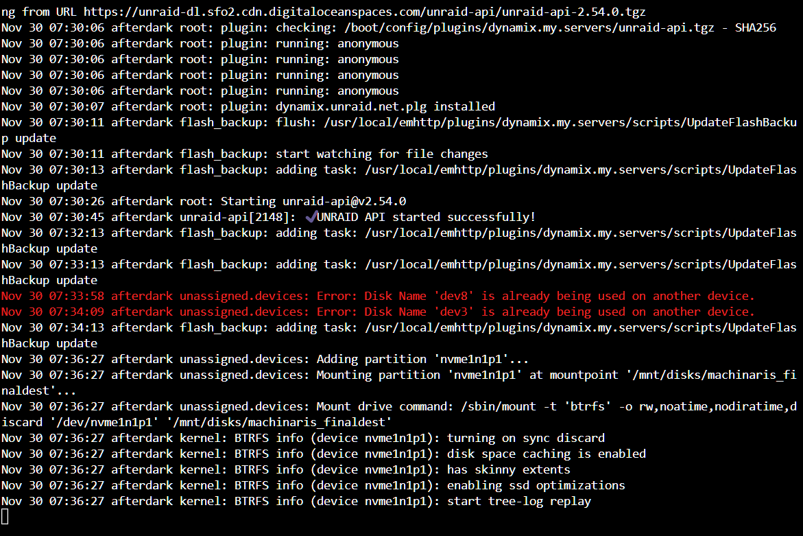

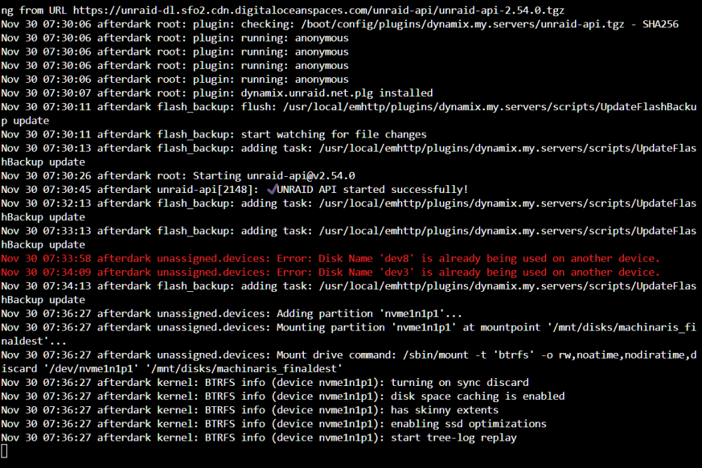

  4. I attached the syslog. After checking, the device is still nvme1n1. I'll try the suggestion above if that's the case but hoping the syslog shows something too. syslog-192.168.164.2.log
  5. Having an issue where the whole server times out and becomes unresponsive. Narrowed it down to Unassigned Devices since I uninstalled all plugins and reinstalled one at a time. When UD is installed and disks are not mounted yet everything is ok. However when I go to mount a drive, the UI is stuck in "mounting" on that one drive i initiated and the server becomes unresponsive. Cannot SSH in either. I had logs opened and was able to capture the last screenshot. I notice it says that "dev8" and "dev3" are being used so theirs duplicates in UD section. However after I rebooted, there were no more duplicate ID's and trying to mount the drive still lead to the same unresponsiveness. I've attached diagnostics for reference too. This only started happening in the past week so any help is appreciated. afterdark-diagnostics-20221130-0734.zip
