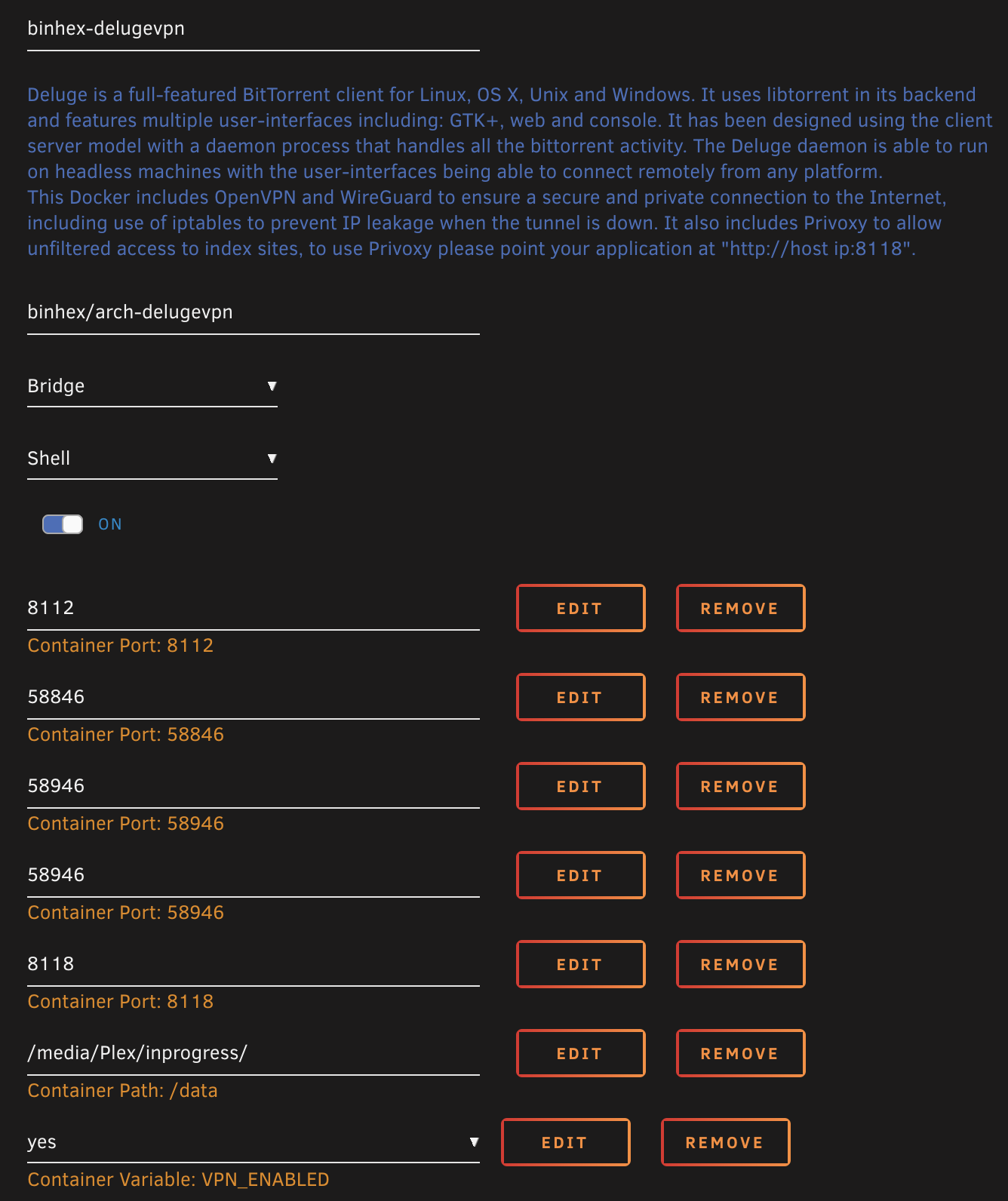

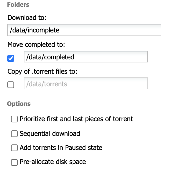

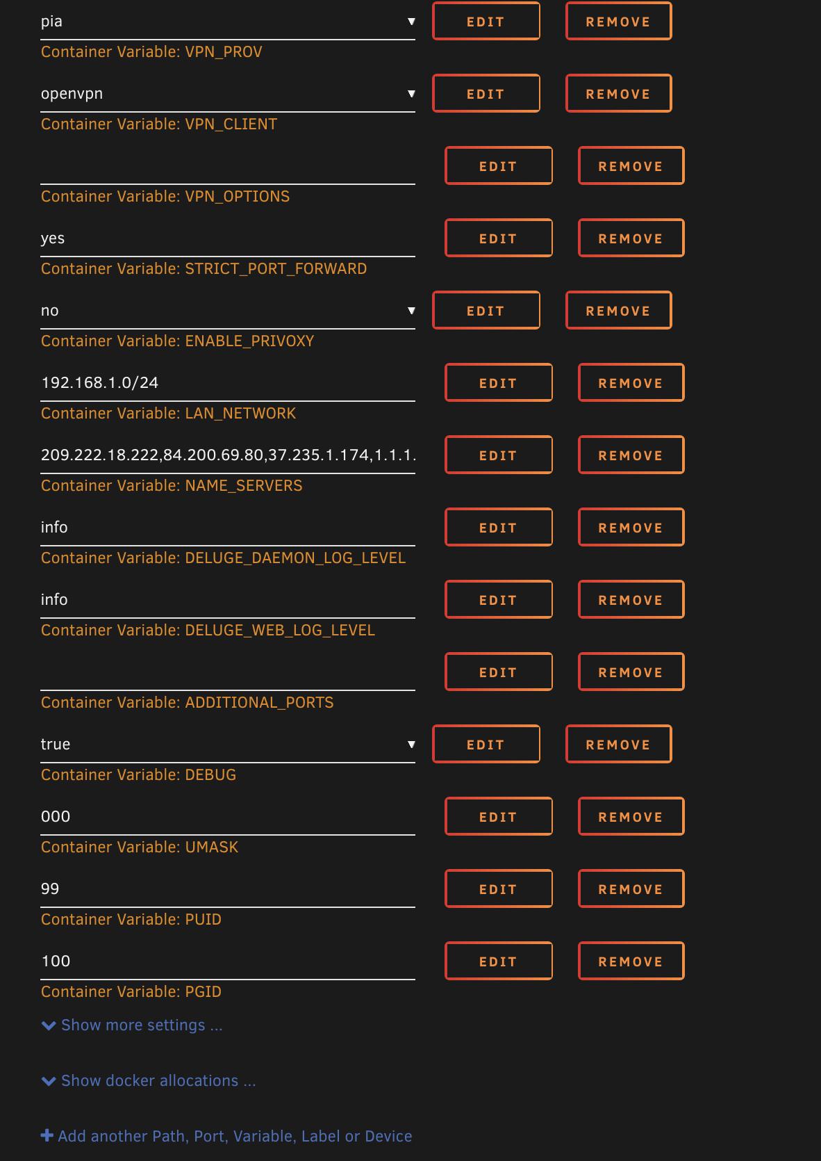

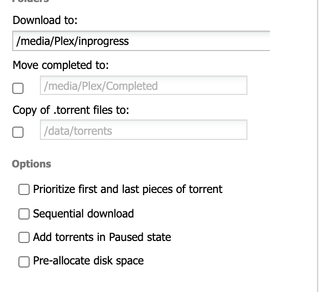

  4. So I went ahead and did that found one for PIA that supported it (CA VANCOUVER) and added it to my openvpn file for deluge. However, it still connects initially and then the peers drop off. I feel like it has to be something to do with my paths and mapping right? Because even when its starts initially no folder is created within the incomplete folder. Here is my updated file mappings after redoing them.

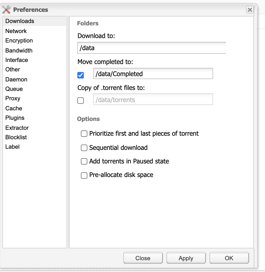

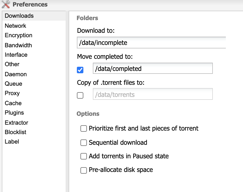

  5. Okay so I think I'm almost finally there, I rewatched spaceinvaderone's video on this and followed it word for word with setting up the new share for downloads and all that. I'm thinking that my issue may be that my PIA OVPN file I chose doesn't support port forwarding? Because after restarting the whole container from scratch and setting up the share it looks like this. I titled my download folders incomplete and completed
  6. If I'm understanding this correctly it should look like this? However, this didn't seem to solve it.
  7. Thanks for the reply! I'll add them in this response.

  9. I've been an unraid user for just under a year now and I absolutely love how helpful the community is and how well it works. It started out just as an easy OS to set up for plex but it has become so much more. Amazing how its been around for 14 years now.
