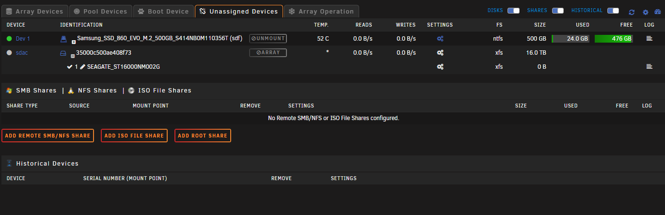

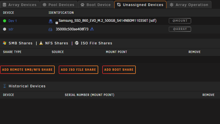

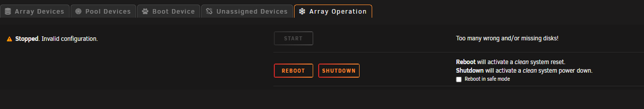

Cable replaced. Rebooted Disk9 not showing up in array, but in unassigned drives its come up as "35000c500ae408f73" and no longer as "ST16000NM002G_ZL20B2RR0000C943E5AA_35000c500ae408f73 - 16.0 TB" Alas, was not able to do a check filesystem as unraid is now saying "Stopped. Invalid configuration." PS: 2 x new 18TB drives available (was planning to use one as my 2nd parity and the other to replace disk2). Now holding tight (and slightly panicy) until further advise. Hopefully something you can suggest to assist. Thanks again,

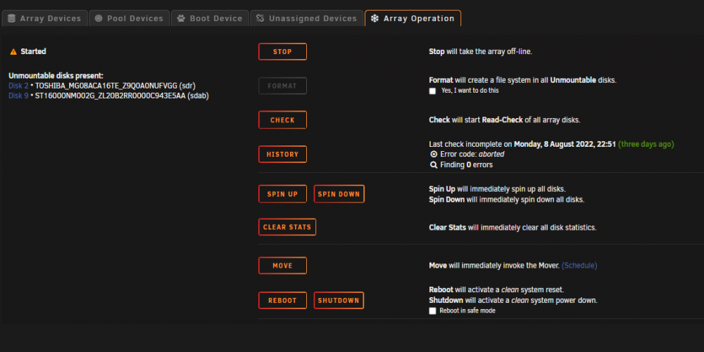

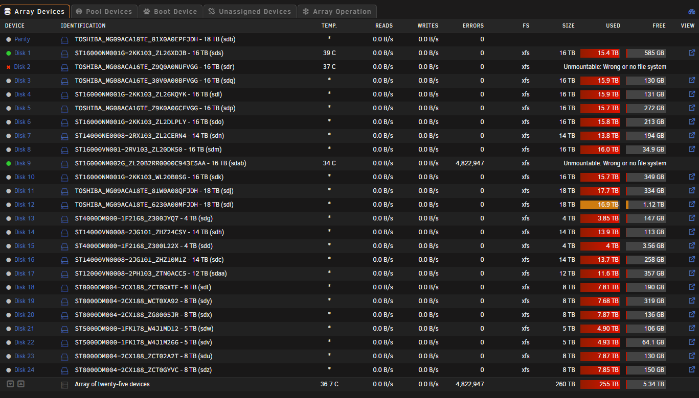

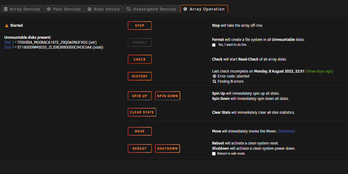

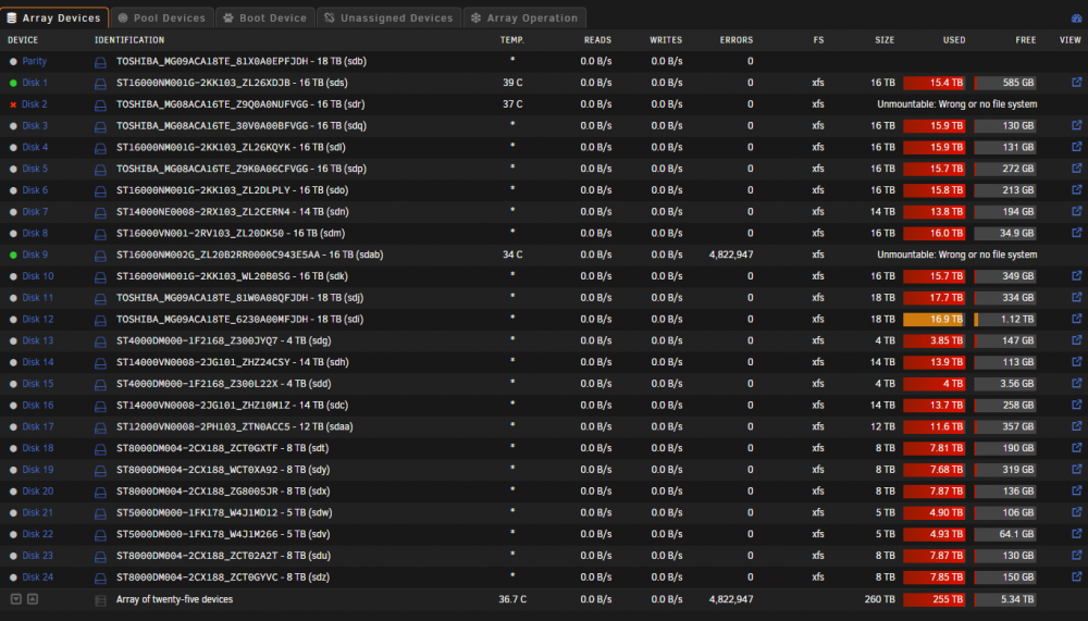

Hello all. Once again, I come to you for help and guidance. During a drive (disk 2) rebuild Disk 9 is in a loop of what sounds (litarally) it trying to start up. I stop the rebuild as it was saying it was going to take over 1000 days to complete and rebooted. Now it is showing unmountable 2 x disk but which are available to format (I won't be doing this as in the past I formatted in error and lost all the data on that drive.) I have 2 x new drives arriving tomorrow and want guidance on how to proceed with hopefully no data loss. ie can I just add the 2 x new drives respectively and Unraid will re-build accordingly or is there more to it? I look forward to your guidance. Many thanks. Al PS: if you notice anything else in my diagnostic that I should look into, please let me know too. kraken-diagnostics-20220811-1800.zip
