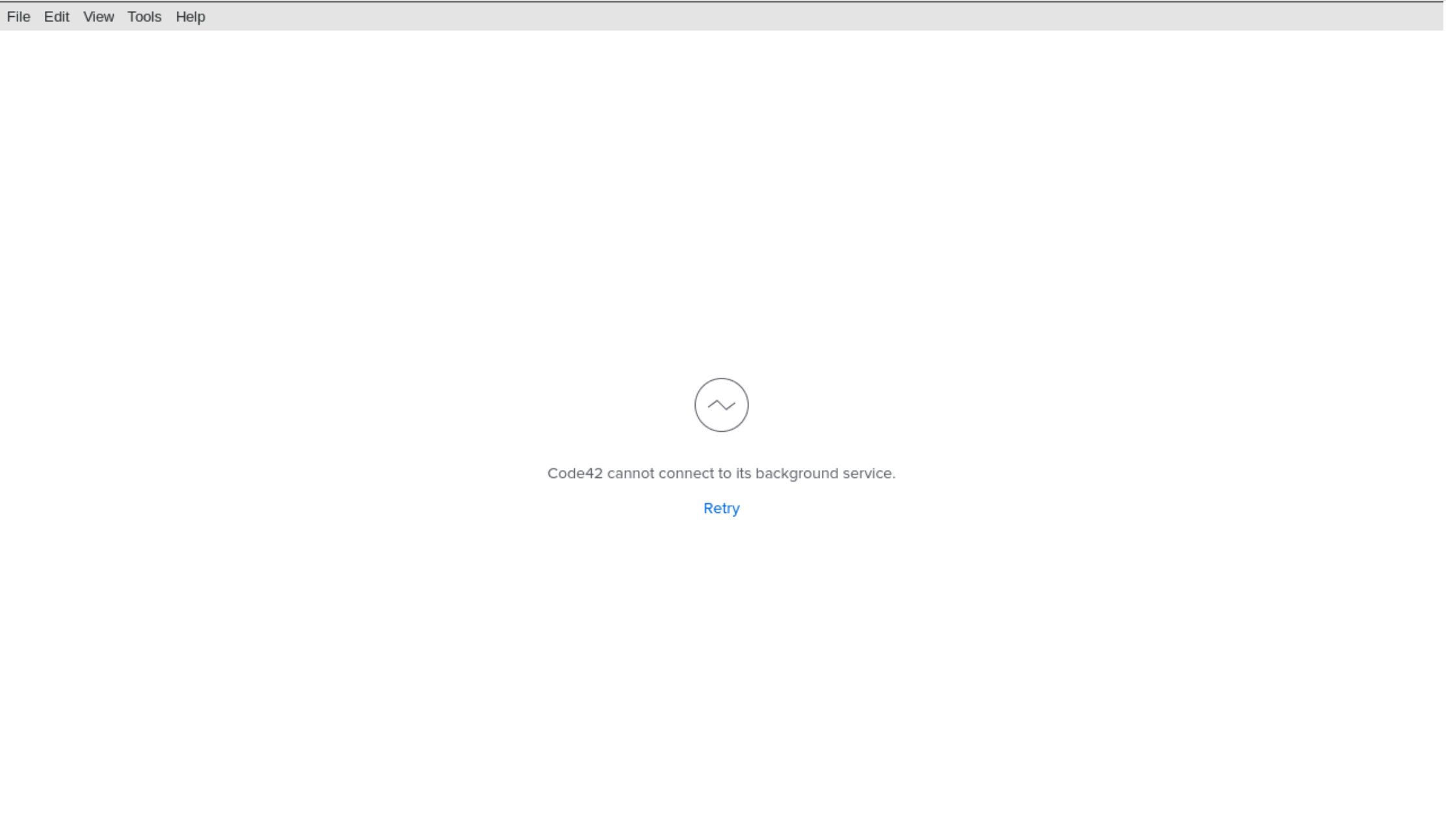

  1. I think I may have figured it out. After another reinstall, I had the docker window open and a warning popped up, and told me CrashPlan is exceeding inotify's max watch limit. I followed these instructions, to increase that limit: https://support.code42.com/CrashPlan/6/Troubleshooting/Linux_real-time_file_watching_errors For now, it seems to have fixed the issue.

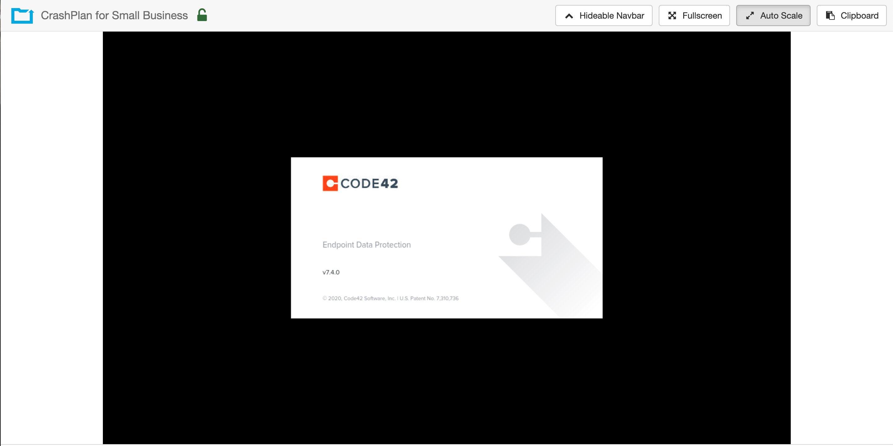

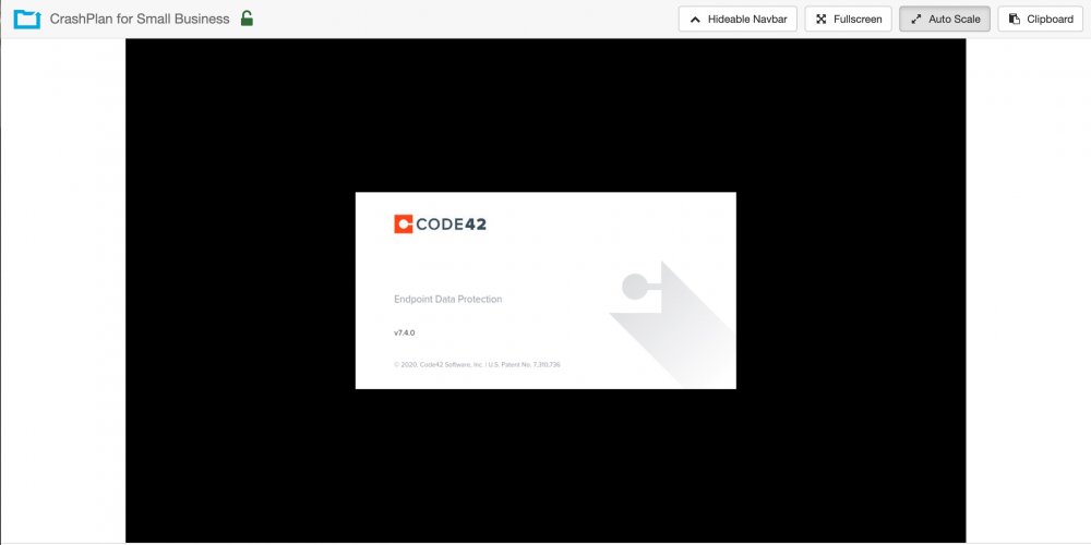

  2. Hi. I've been trying to get this to consistently work for over a week, and I'm not sure what I am doing wrong. At first, the initial login worked as expected, I setup an initial test backup. After the initial login, I was not able to get into the WebUI again. I tried everything I could think of. So I uninstalled the docker and resinstalled it, then it allowed me to login again. I tried both setting up as new device, then replacing an existing device, neither options makes it all the way through the setup process. The app just gets stuck on connecting no matter what I do. So I tried to restart the docker, and it either shows a black screen, or sometimes shows the 'connecting' screen, which it indefinitely hangs on. So, I uninstalled, removed the image, manually delete the settings, and then it will allow me to login again. I then go through the setup process, and either at the end, or towards the end, it gets stuck on 'connecting' again. Any tips? I've tried allocating anywhere from 8gb to 64gb to the container. I've currently got 16 cores allocated to the docker. I've set permissions as root, and assigned priority of -20. Not sure what else I can do. *correction: Here are the three different screens i get stuck/hung on. I was able to backup a large portion day 1, but after that it hasn't backed up anything. I even tried removing the initial device in (crsahplan for business main UI), and then starting over from scratch, but that didnt work either.
