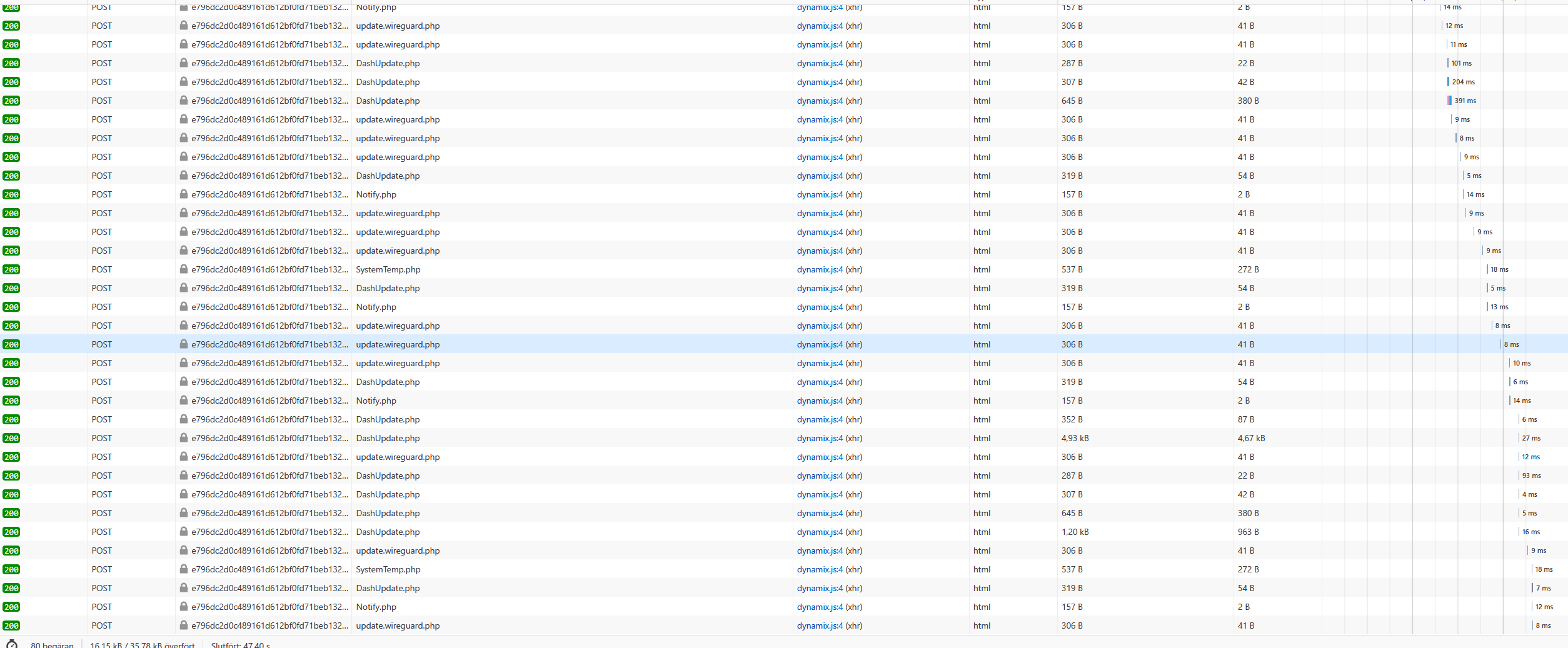

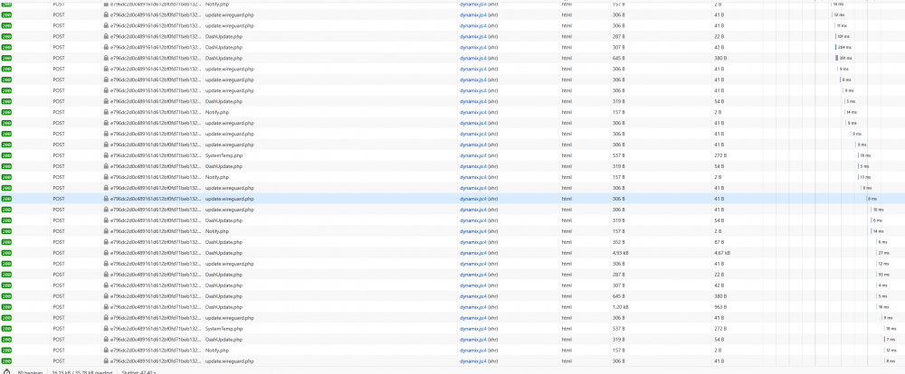

  14. I run Cryptomator, I think it utilizes WebDAV. I’ll check it out!
