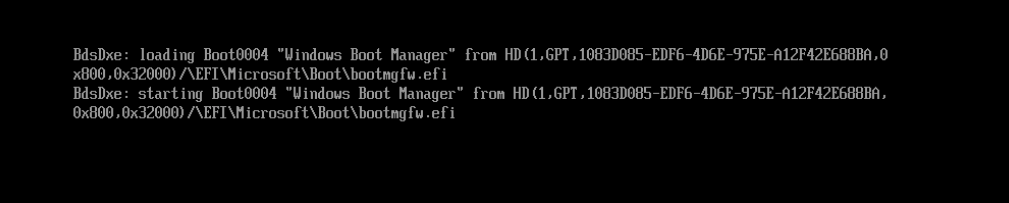

  6. I'm having this same issue did you ever figure out what was going on?
  7. No I had to rebuild one of the VMs that I couldn't get to boot at all. I have 5 other VMs that all show that same message, some with GPU passthrough and some without. Even the new VM shows that message. Did you make any hardware changes? I only got that message after switching from AMD cpu\mobo to Intel.
  8. Upgraded CPU and motherboard this weekend and now all VMs showing weird message after starting the VM. Most boot and don't seem to have issues but I didn't have rebuild one. Curious of the cause and if there is a fix, something to worry about, or just a little message. I did switch and an AMD configuration to Intel. Nothing is passed through on the VMs, no GPUs or storage. This does happen on both Windows and Linux VMs as well. Storage is mostly NVMe drives (not passed through, just a cache drive) and an SSD. Diagnostics and screenshot of the message are attached. darthvader-diagnostics-20230306-1323.zip
