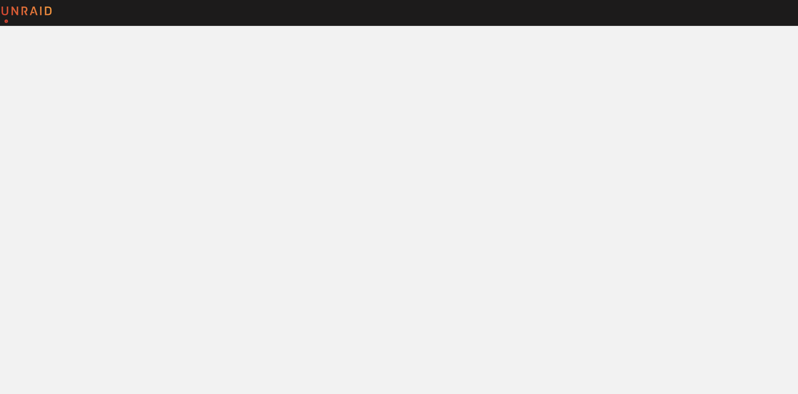

Hello, I upgraded to 7.0 from 6.12.13 and everything seemed to go okay except after a successful boot I will lose access to the webUI after a few hours. Tried looking through the syslog but wasn't able to find anything in the time from when it was working to when I can no longer access the webUI. SSH works fine and VMs and dockers all seem to be working normally as well. I can reboot the server from SSH and then webUI access will return for a few hours. The login page will still appear as normal but the broswer will either just spin or the UNRAID logo will appear but the rest of the page is just blank. Screenshot and logs are attached. Thank you!

There's nothing logged that explains what is happening, try booting in safe mode to rule out any plugin issues, also try using a different browser, or even a different device to access the server, like a phone or tablet.
