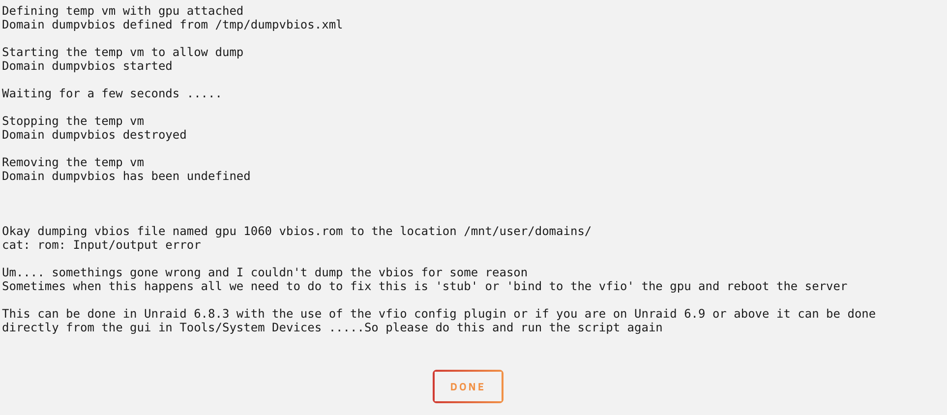

  1. Having trouble dumping vbios from the second GPU. The first one works perfectly, it’s a GTX 1070 and sitting in the main slot Second one is a 1060 and sitting in the pcie_2. And getting this error. Any ideas?
  2. Hi all! So far i've been using Unraid with a Win10 WM with a gtx 1070 gpu. Have looked through Spaceinvaders videos to set that up and that has worked perfectly. And now i want a second WM with it’s own GPU. So i bought a 1060 3gb. And trying to set that up, well i can’t get it to work with the GPU. Looking at spaceinvaders vbios dump video and trying his script. But that only works for the first 1070 and not the 1060. Found the old video to get the vbios online and editing the hex, as i did with the 1070 when i created the first wm. The second wm start fine with both VNC and the 1070. And since i'm a bit of a noob i don’t know where to continue looking for solutions. What info do you need from me to help me? Thanks in advance! Systems specs:
