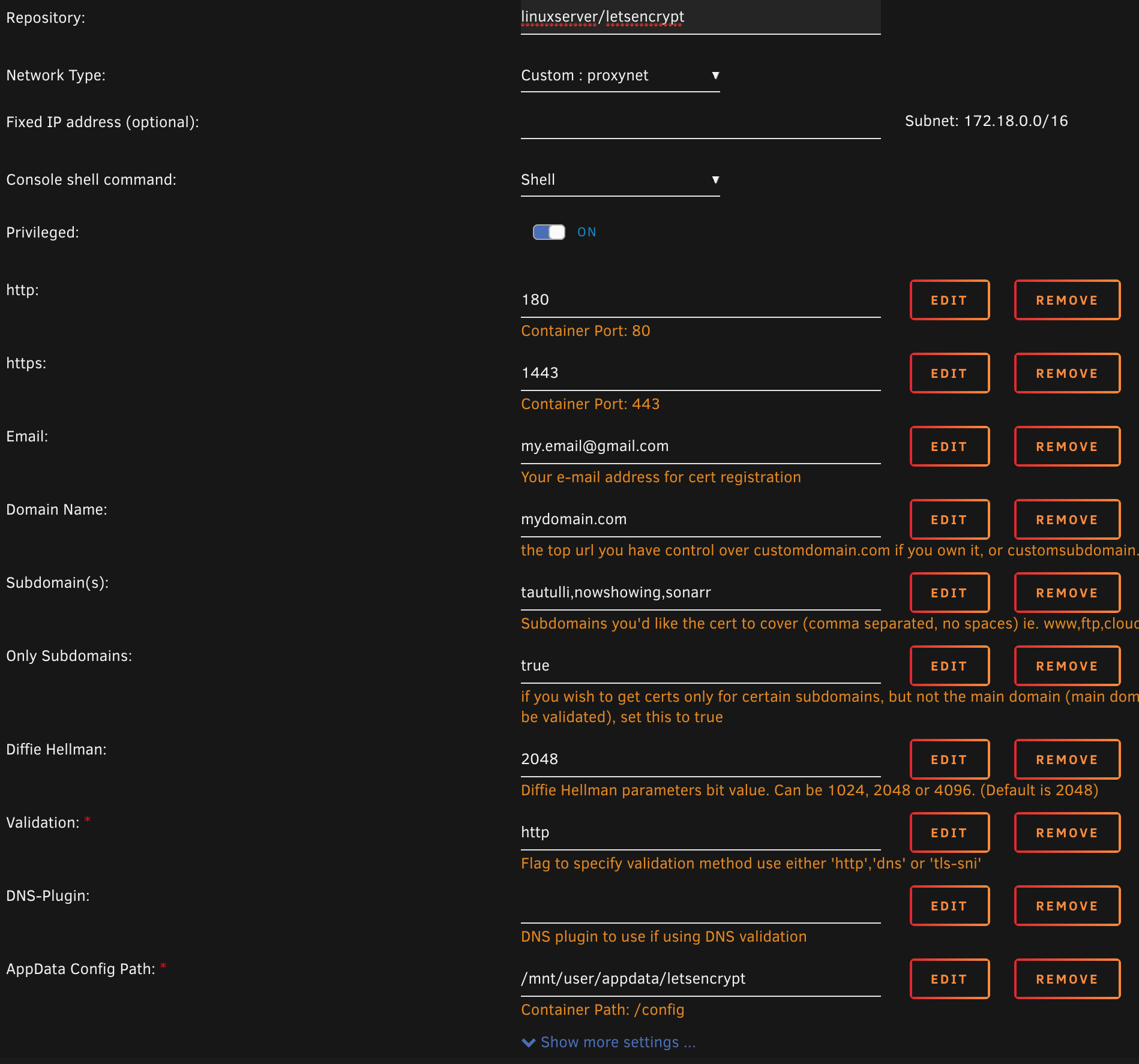

I FINALLY FIGURED IT OUT!!! It was my UniFi USG that was the problem. It needed to be rebooted to pass the ports properly. Once it rebooted I was able to access Sonar immediately using my subdomain. The only problem I have now which is a cosmetic one but it's going to irritate my OCD is it only works if the Docker container name is lowercase sonar. I like to have my dockers properly labeled so I would like it to be Sonar. I went into the Proxy-Conf folder and changed the set $upstream_sonarr sonarr; to set $upstream_sonarr Sonarr; in both locations then restarted LetsEncrypt after changing the container name back to Sonarr but I get a 502 Bad Gateway when I do. Is there something I can do to fix this naming dilemma. Also, does anyone have a proxy-conf file for NowShowingv2 Thanks,

I am having a similar issue. I don't know where my disconnect is but I think it's with the ports not passing to the docker. So I also follow SpaceInvaders tutorial. I have a domain hosted with GoDaddy and I have setup CNAMES for Sonarr, & Tautulli to test with. They are configured as subdomains that point to my duckdns.org address. I have the DuckDNS docker installed on my unRAID server and it is properly updating the IP. When I pass my subdomains through https://www.whatsmydns.net/ I can see that the subdomain URLs are correctly pointing to my duckdns.org address. I have configured my UniFi USG to pass the port 80 to 180 and 443 to 1443 to the IP of the unRAID server. When I check ports 80 and 443 at https://www.yougetsignal.com/tools/open-ports/ I see port 80 open but 443 is not. Not sure why... I've edited the .conf files to reflect the names of the docker containers. At this point, I am just confused as to why this is not working. Here are some screenshots of my configurations: # make sure that your dns has a cname set for sonarr and that your sonarr container is not using a base url server { listen 443 ssl; listen [::]:443 ssl; server_name sonarr.*; include /config/nginx/ssl.conf; client_max_body_size 0; # enable for ldap auth, fill in ldap details in ldap.conf #include /config/nginx/ldap.conf; location / { # enable the next two lines for http auth #auth_basic "Restricted"; #auth_basic_user_file /config/nginx/.htpasswd; # enable the next two lines for ldap auth #auth_request /auth; #error_page 401 =200 /login; include /config/nginx/proxy.conf; resolver 127.0.0.11 valid=30s; set $upstream_sonarr sonarr; proxy_pass http://$upstream_sonarr:8989; } location ~ (/sonarr)?/api { include /config/nginx/proxy.conf; resolver 127.0.0.11 valid=30s; set $upstream_sonarr Sonarr; proxy_pass http://$upstream_sonarr:8989; } } # make sure that your dns has a cname set for tautulli and that your tautulli container is not using a base url server { listen 443 ssl; listen [::]:443 ssl; server_name Tautulli.*; include /config/nginx/ssl.conf; client_max_body_size 0; # enable for ldap auth, fill in ldap details in ldap.conf #include /config/nginx/ldap.conf; location / { # enable the next two lines for http auth #auth_basic "Restricted"; #auth_basic_user_file /config/nginx/.htpasswd; # enable the next two lines for ldap auth #auth_request /auth; #error_page 401 =200 /login; include /config/nginx/proxy.conf; resolver 127.0.0.11 valid=30s; set $upstream_tautulli Tautulli; proxy_pass http://$upstream_tautulli:8181; } location ~ (/mnt/disks/PlexMediaServer/tautulli)?/api { include /config/nginx/proxy.conf; resolver 127.0.0.11 valid=30s; set $upstream_tautulli Tautulli; proxy_pass http://$upstream_tautulli:8181; } } Any assistance or guidance would be greatly appreciated!
