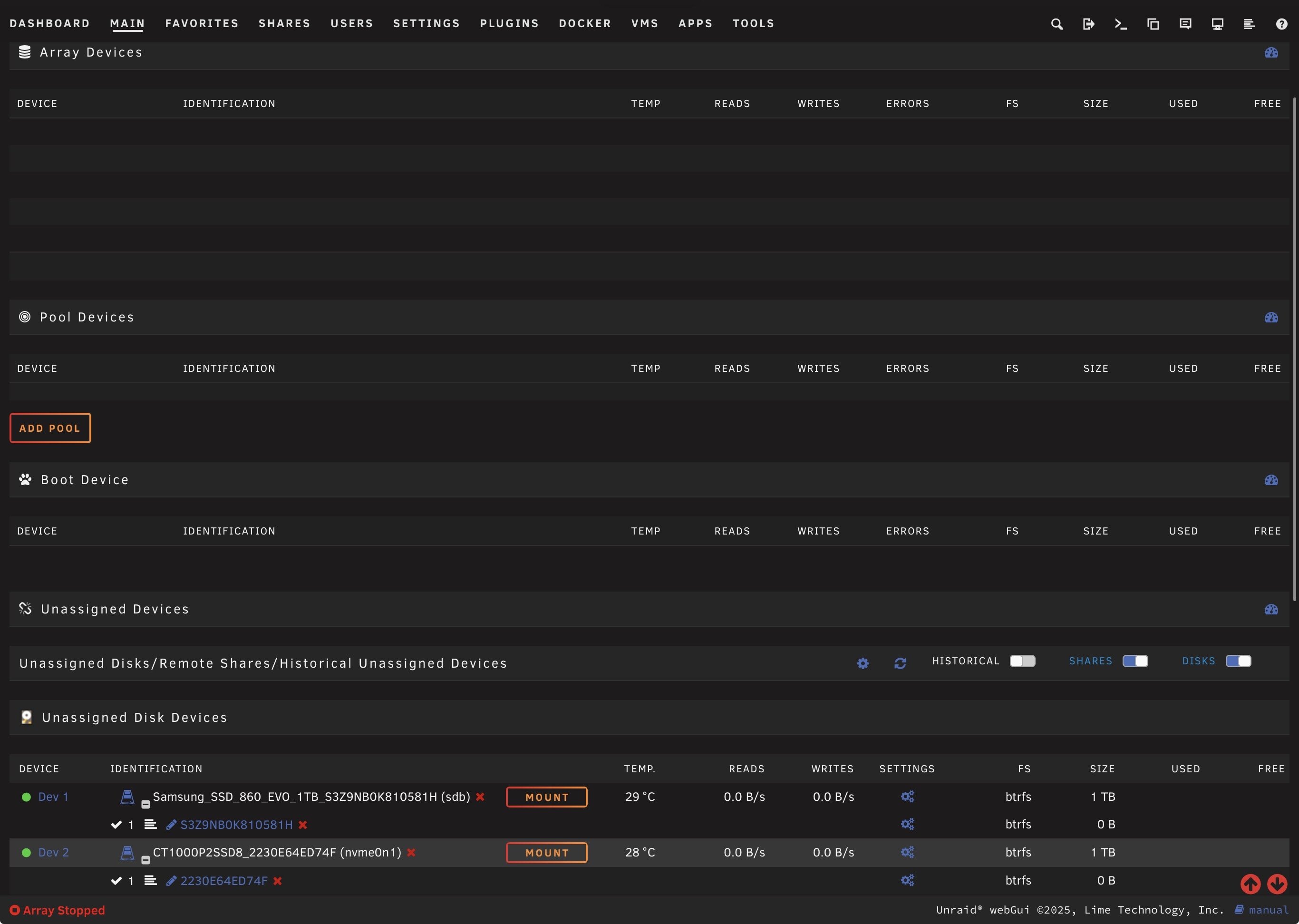

  1. Thanks, I’ve tried it with Safari on iPad, Chrome and Firefox on Windows and the issue remains.
  2. Hi all, I’m running into an issue where my cache/pool devices are no longer visible in the Unraid UI. Context: Unraid version: 7.2.4 I recently moved the server to a new physical location (same hardware, just relocated) After powering it back on, I started troubleshooting and the pools disappeared from the UI I’m unable to start the array without the pool devices setup correctly When I try to add a pool with the same name as the old one (cache) I get an error saying the pool already exists, though not visible in UI. What I’ve done so far: Booted into safe mode Checked /boot/config/ and confirmed: super.dat exists pools/ folder exists Restarted nginx (/etc/rc.d/rc.nginx restart) Rebooted multiple times Accessed Unraid through Safari on iPad, Chrome and Firefox on Windows. Current state: /boot/config/pools/ exists super.dat is present However: No pools show up in the UI Even the boot device appears empty in the UI Disks themselves appear to be detected at the system level Diagnostics: Attached Thanks in advance! tower-diagnostics-20260402-0023.zip
