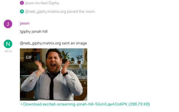

  4. No shame there, a life without silly gifs is a life I don't want to live! I just tried it out and it worked fine without any issues. The Firefox javascript console was a lot of help in getting it all sorted out. There might be some hints there.
